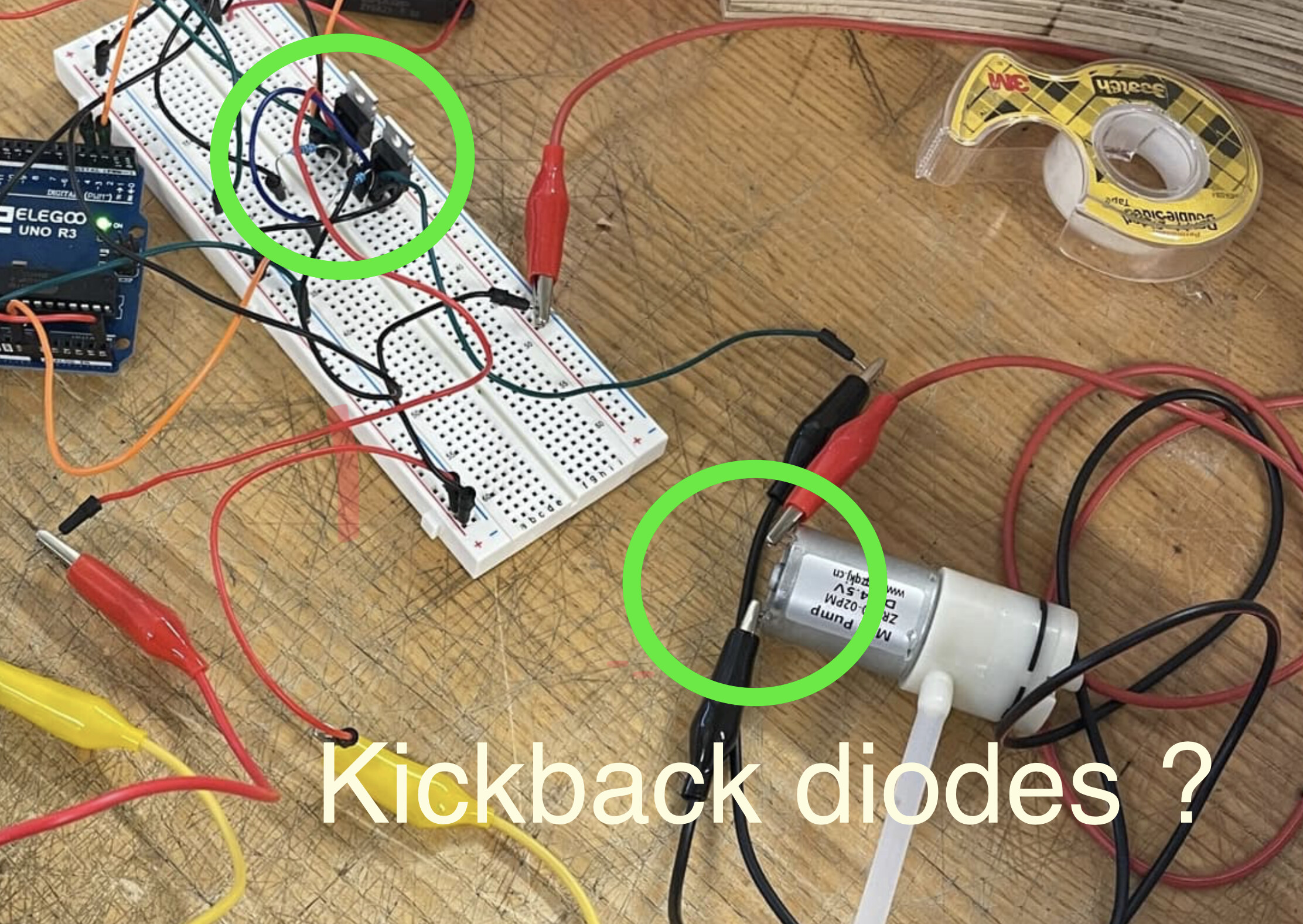

Hello,
I am currently working on a masters project where I am using an inflatable material that will inflate more rapidly when no one is detected and then once someone in detected the inflation will return to a more calm state (similar to that of a calming heartrate) I am using mini air pumps and an IR sensor to control this. I borrowed a code and set up the breadboard, but having trouble getting the air pumps to turn on. I will post the code and the circuit below. In the circuit diagram it shows A10 but however in my breadboard setup I used A5 as reflected in the code. Does anyone know why the air pumps are not bring activated?

Start by running the motors from their own power lines. Don't run them through the board.
I can't see how the pump motors are buffered.
Which motor drivers are you using?
I am using 4.5V mini air pumps
But how are you buffering them?
An I/O pin can't drive a motor directly, so what device is between the I/O pin and the motor?
Hopefully this image helps, I am new to arduino so I am not sure what you mean by buffering?
You also don't have a resistor in between the board output and the FET gate.
An I/O pin has an absolute maximum rating of 40mA.
The spec says the pump motor draws 600mA.
See the problem?
(I can't see your schematic, and your photo is too small to see on my phone)
Confirm you are using a separate external 5v power supply for the motors.
