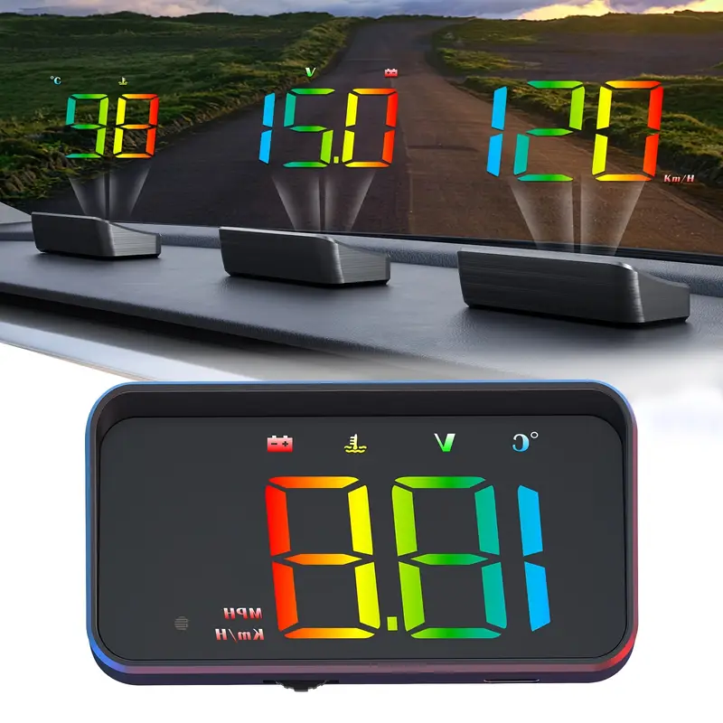

many txs for your quick response, but won`t help.
I think it will double the output.
The screen should look like the lower part, to be displayed correct in the semi transparent mirror.

ah OK - when you wrote "mirror", you meant in the sense of create the reversed image. I understood you wanted to have the same one duplicated.
As you have commands going into the display, "mirroring" won't be just a wiring thingy. You'll need to be able to handle 2 screens in the code and every time you issue a screen command to display something you'll have to calculate the mirrored command for the other screen.
That would appear to be a simple transformation. The new value of any X coordinate (that is a coordinate on the horizontal axis) is the screen width minus the old X coordinate. Have you a code sample which writes to the display ? There may be somewhere in the library that you can hack such a change.
