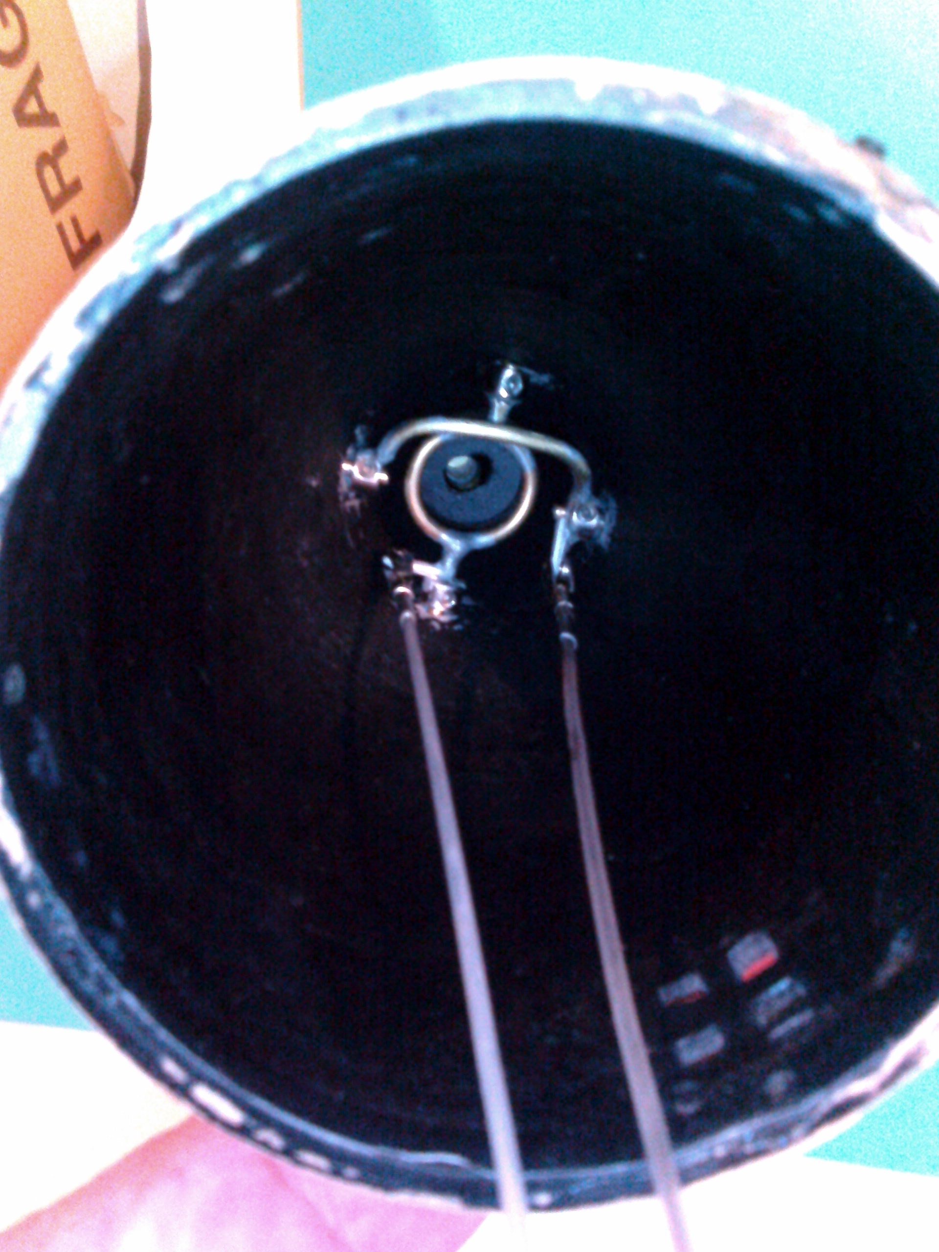

I use two standard servos and a Futaba transmitter. Servos are connected to rudder by actuating rods in the following sequence:
  1. Dive or surface motion: Both servos proportionally work in opposite direction pushing the rods to have the rudders in X up to dive and X down to control the pitch and surface or dive the submarine
  2. Starboard or portboard motion: Both servos proprotionally worh in the same direction pushing the rods to have the four rudders to the right or left side orientation to control the yaw and turn right or left the submarine
Here attach some explanation photos:
