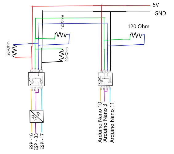

Modbus communication via Max485 between ESP32 as Master and Arduino Nano as Slave
At the moment the master Max485 chip and slave Max485 are with following connections
I don't understand how should I change?
I see 2 new resistors, not in original diagram nor in the pic of breadboard which is what I have been referring too..
new pic please of current hookup..

I'm sorry, I introduced them this morning at dawn after having better read the TTL Max485 scheme which inserted pull up and pull down resistors on the master side to stabilize the signal ... and after reading this attached document on fail safe ... however the current situation is as follows as in the picture

Pretty sure you're gonna need them ceramics..
real close to vcc on both max chips..
red and blue wires that connect busses between boards..
try moving those to the chip not using the + and - busses as connection points..
go back to just terminators and probably would work without them too..
you should be able to omit the max chips and use the level converter for rs232 and see if you can send data that way, then you will now, it's in the max circuit..
you're getting something, so i don't think it's software, definitely garbled..
still, caps..

Forgive me for taking more time, but I didn't understand very well what you are saying, let me summarize:
  1. Sketchmaster; should be OK
  2. Sketch Slaves; since it receives the signal from the master and he doesn't respond, you think it's a hardware issue...
  3. You ask me to swap the bus wires, A and B to try and to insert two 20 kOhm resistors also on the Max485 of the slave
....it's correct? Did I understand correctly what you are saying?
  1. Sketchmaster is sending now, that much I know.
  2. Sketch Slave appears to be receiving gibberish (slave not responding see below).
  3. No you misunderstood me, sorry.
If the slave receives the query, but detects a communication error (parity, LRC,
or CRC), no response is returned. The master program will eventually process
a timeout condition for the query
Page 94 Exception Responses
Sorry.. ~q

put all that aside for a bit and try getting hello received on the slave..
master..

use the 1st slave sketch that just writes what it gets and you should see a hello every 10 seconds..
let's see some hellos..

As you can see in the post I reinserted the pattern and I also took a picture of you.
Now let's move on to the software part. I proceeded to load the sketches you indicated on the Master and on the slave (I had to add a few serial.print lines for debugging. Unfortunately, the result is not the expected one, instead of the Hello message appearing on the serial monitor of the slave, a 0 comes out first and immediately after another 0, and this every 3 seconds (I reduced the time compared to the 10 seconds you indicated because it was a very long time to wait).
But something new happened that had never happened before and that is that this time both the leds on the ESP32 and on the Arduino nano flash in synchrony every 3 seconds.
FYI, I tried removing the 20K pull-up resistor and the slave output went from 0 0 to 255 as photo. your opinion: what can it mean to pass from 0 to 255, it seems from a low value to a high value...

Wasn't leaning that direction..
A couple of 485 boards and we wouldn't be here now, but what ever..
Been thinking about what else to try..
Still don't like how the A and B on the max chips plug into the breadboard busses..
Try this, remove resistors, connect the 2 max chips A B directly..
Try first at 9600, if no go reduce baud rate really low, like 300 on both sender and receiver and test again..
I also didn't like the level converter either, but I have seen they do make high speed ones so, I've ignored it..
The output of the level convert should be compatible with the nano, so you should hypothetically be able to omit the max chips and test level converter using 232, send to recv, recv to send, no changes needed to sketch should get hellos..
max chips could be going a bit crazy, they switch fast, the ceramic caps real close to each vcc to grnd might be necessary not optional..
or just order a couple of 485 adapter boards and move on..
good luck.. ~q
PROBLEMS SOLVED
I'm not going to explain everything I had to do....it would be too long in a language I don't know very well, but I'll give you the final solution.
Scheme to run like the one shown in my previous post by eliminating the 20k resistors.
