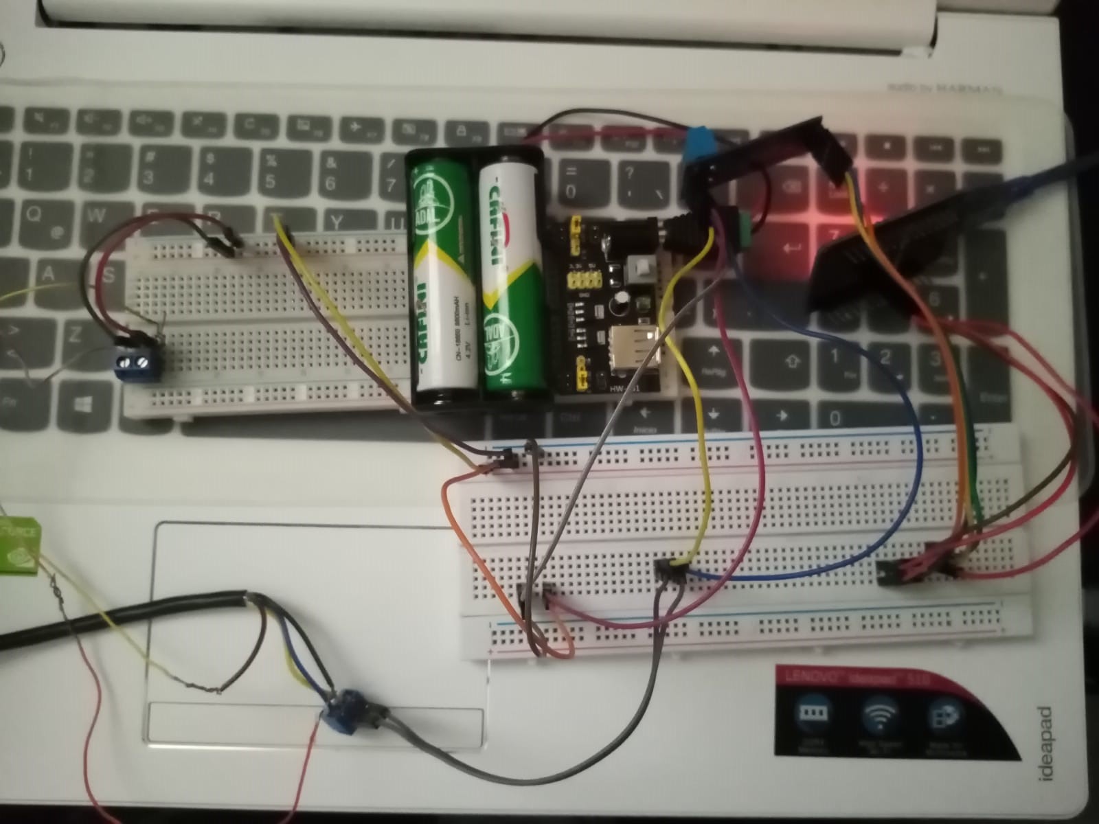

I have been doing tests connecting to WIFI and through Serial Port the communication with the sensor to see if there is any interference.
However, the output is the same.
[SETUP] WAIT 2...
[SETUP] WAIT 1...
Conected to WIFI!
Conected to WIFI!
Message Timeout
Conected to WIFI!
Conected to WIFI!
Message Timeout
This is my code:

I have tried connecting RE y DE to PIN 33 and then with 4.
But I'm still there without the sensor printing data.
Please dear @Blackfin I need your help to achieve.
