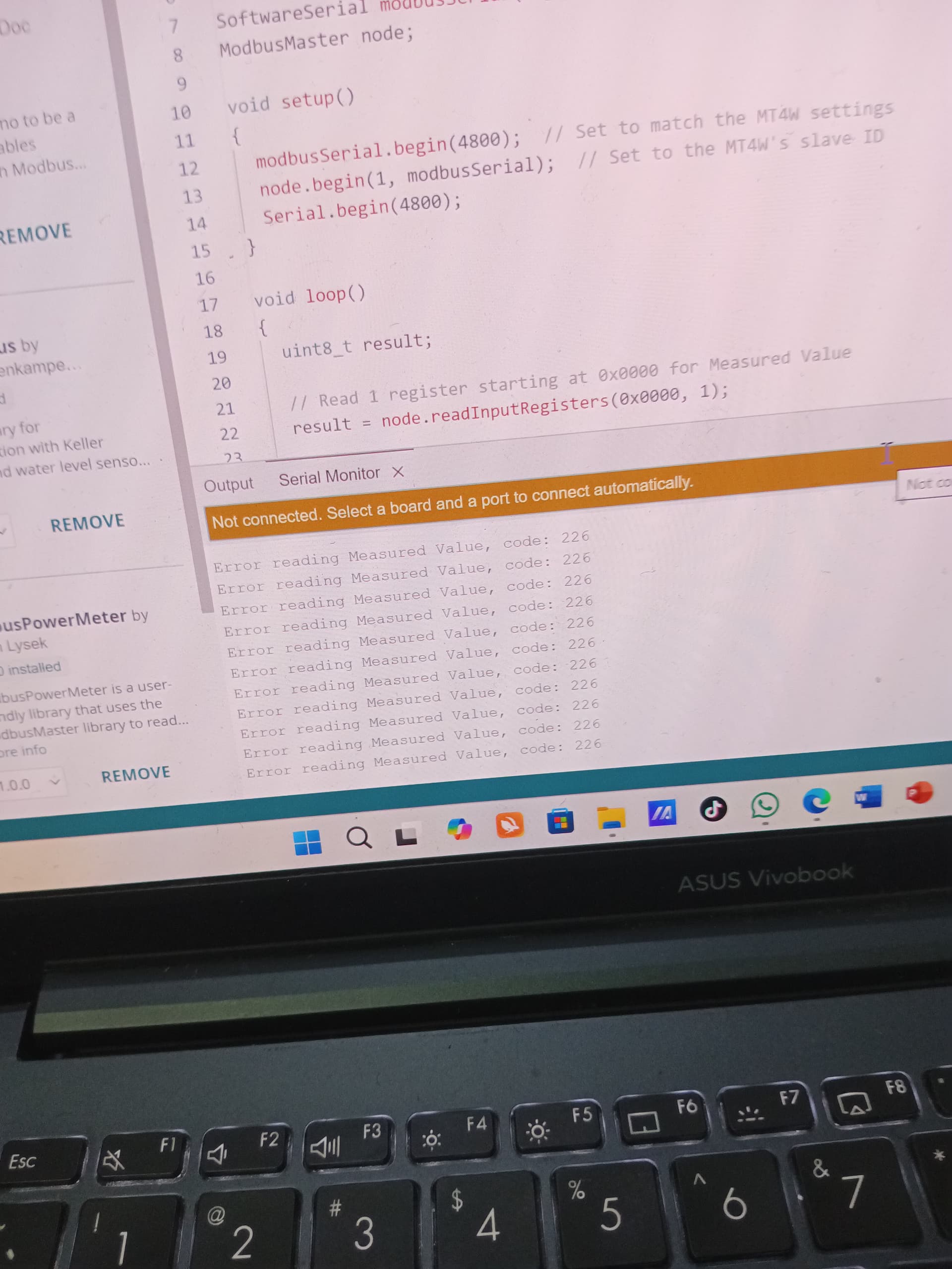

I have problem with reading data from autonics mt4w through rs-485. Ive been following every step that i watched from youtube edc. And keep failing to read either holding register or input register. This is my code:

Does anyone has experienced to help me to read value from autonics. Thanks
Have you tried to test communication mt4w via software modbus poll with modul RS485 to ttl?
please follow the forum how to and post your code in code tags.
It is described here:
You can edit your first post and put the code in code tags.
Error Code 226 (in hex 0xE2) means the device is not responding - you might have a wrong connection.
provide following missing information:
  • upload a schematic so we can see how you want to connected your components
  • upload pictures so we can see what you have connected in reality
  • link to the datasheet of the "MT4W" so we can check the supported modbus functions and addresses
