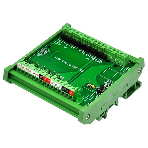

I'm using this Uno break out board to connect the ethernet shield to.

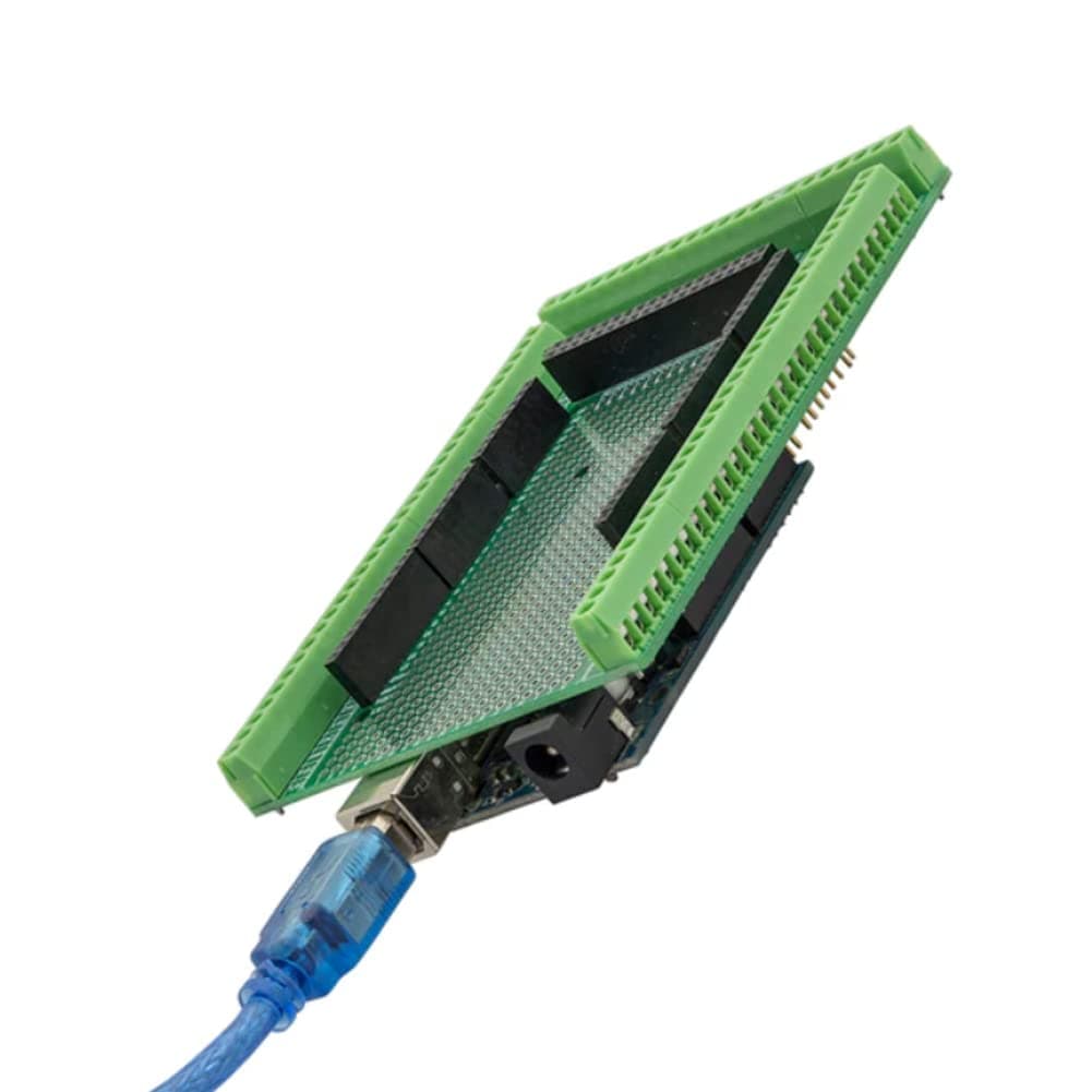

I'm using this Mega break out board to connect the Mega to.
Unfortunately, both break out boards require both arduinos to sit upside down, making accessing the ICSP pins a PITD.

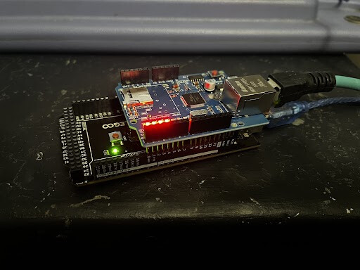

To start, with the shield stacked directly on the Mega, I can statically set the IP, gateway, and mask, and ping it.
However when I put them on the break out boards I lose that ability. Come to find out, on the Ethernet shield pins 11, 12, 13 DON'T connect with the ICSP pins. So hard wiring between screw terminals on both break out boards produced no IP's.
Then I used proto wires from the screw terminals of the Mega to the ICSP socket. This would produce 255.255.255.255 for the IP, gateway, and mask. Still using the same sketch.
I used combos of hardwires to the screw terminals and ICSP socket from the Mega, and just fully wiring from the Mega to the ICSP socket. The IP's would never be right.
I'm not sure if there needs to be any other wires between the break out boards other than the 6 ICSP connections in order for the shield to work right. (5V, GND, RST, MISO, MOSI, SCK)

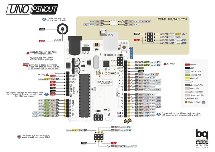

  1. For the Uno R3, the ICSP pins are also available on 11/12/13 (SS on 10).
  2. For the Mega, the ICSP pins are also available on 50/51/52 (SS on 53).
Below an older pinout for the Mega
I don't have one for the Uno, do a search for Arduino Uno pinout
Uno pinout by the same person.

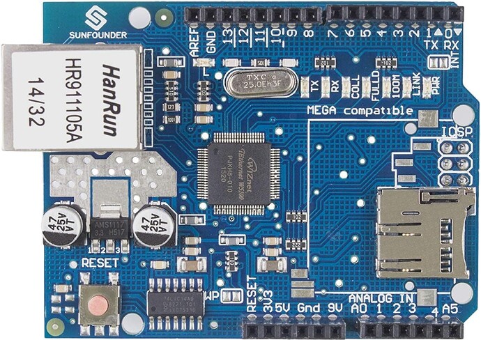

Yes, understood, the problem became that the ethernet shield I have does not connect the ICSP header to pins 11, 12, 13 as expected. I get zero continuity between the ICSP header and those pins when checking with my meter. (I do on the Mega, as expected).
So I worded it poorly, it's not the fault of the break out boards, rather the shield.
Trying to wire from pins 50, 51, 52 on the Mega break out, to the ICSP header on the shield produced really really weird results with the IP addresses. (255 filling every byte in all addresses, and somethings 0.0.XXX.XXX in the mask if "jiggling" the pins on the ICSP). I could only ever get the addresses to set and display correctly in the serial monitor if I just stacked the shield directly on the Mega, removing all break out boards.
The shield is a Sunfounder W5100.

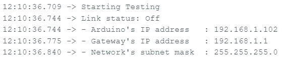

If I stack the shield on the Mega like normal:
The program produces the correct info in the serial monitor:

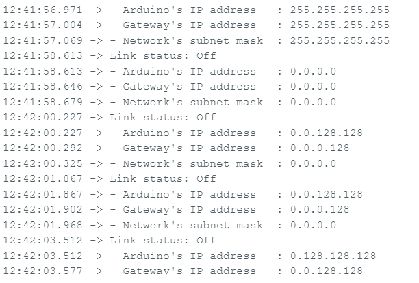

However, when I move them to the breakout boards and wire them up in the following manner, I get bogus results.
Mega screw terminals to
Uno shield screw terminals and ICSP pins
5V / GND / RST / 50....../ 51....../ 52
5V / GND / RST / MISO / MOSI / SCK
The program produces garbage like this:
I confirmed I have the shield ICSP pins correct. In that orientation L to R, T to B the pins would be:
RST........... / GND
13(SCK).... / 11(MOSI)
12(MISO)../ 5V
I verified by confirming the RST, GND, and 5V ICSP pins all have continuity to the screw terminals for the same.
Pulling the ICSP wires will change the random garbage I get in the serial monitor. For S&G's I swapped the MISO/MISO and the SCK wires all around. All garbage combinations.
Connected 3.3V between the breakouts just to test. No change.
But, if I put the shield directly back on the Mega.... it's all ok.
What am I missing?

I have bought that proto board shield to try, along with some pin extenders.
Should be able to sandwich the board between the Mega and Ethernet shield and still have screw terminal locations.
I do lose the ability to DIN rail mount it though.
