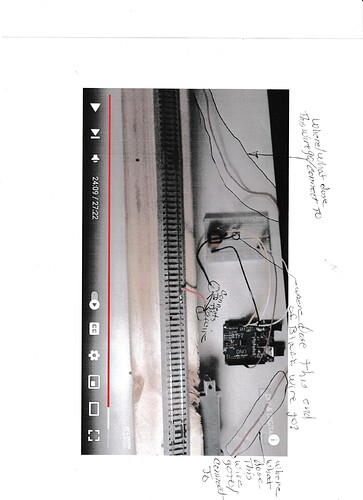

Here is a screen shot of your current transformer/ Arduino project. I hope you can view it. I jiust want to know where the circled wires go to/connect to. Not explained in your Youtube video and I could not pull up and see any kind of schematic in your SHOW MORE section.

That's my question. These 3 wires do they just connect to your power transformer that operates your locomotive or some thing else.
Probably not. It looks like you are trying to make the Arduino power your 12vdc ~18vdc train. That would burn your Arduino.
What is the input to your transformer?
What is the output from your transformer?
My train was powered like this:
(mains)==>>A/C==>>(xmfr)==>>12vdc==>>(tracks)
Polarity was not important for my tracks because my xmfr had a "reverse" switch.
Well from what I understand the Arduino runs on 5-7.5 Vdc which is lower than track voltage and from a different power source NOT the track transformer. I was wondering if the black wire warped around your current transformer goes to your track transformer wrapped around your current transformer then goes to your isolated rail connected to your orange wire. Now the wire connected to your rail before and after your insulated rail connector just wondering if they go back to the same transformer connection that your current transformer lead wire goes to. In other words do you have 3 wires hooked up to your track trans former on the same terminal regardless of polarity. So you can regulate the speed and direction of your locomotive. Keep in mind the Train transformer DOSE NOT power the Arduino. That is a separate lower voltage power source which I know.

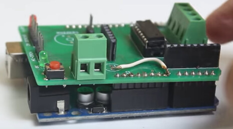

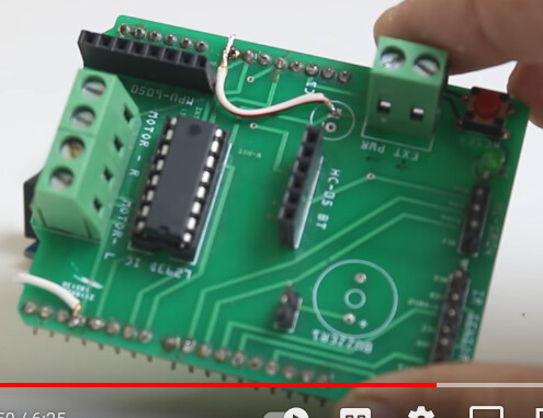

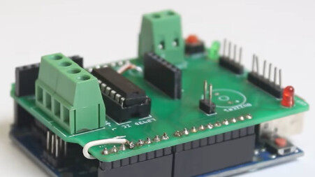

Saw a Youtube video by Mr Innovative titled 'Arduino PID based DC motor position control system'. Looking for some sort of blue tooth shield kit he purchased and built. Can't find a part or part number or US distributor to purchase this. I downloaded some photo's so hopefuly some one can recognize this and let me know what it is and where I can buy it.

"Mr Innovative" provides a link to fab the PCB yourself. Probably not too many people bother, as it isn't really a great board. The motor IC is weak, and it looks like the bottom of the row of header pins is dangerously close to hitting the USB connector shield and shorting out.
What is the controller You want to use? Goggle on that board + Bluetooth shield. There are likely several ones out there.
The IC look like a 74374 or somthing, a digital circuit... Not a typical BT circuit.
It looks like an L293D H-bridge driver and a place to plug an HC-05 bluetooth breakout and an MPU-6050 breakout.
