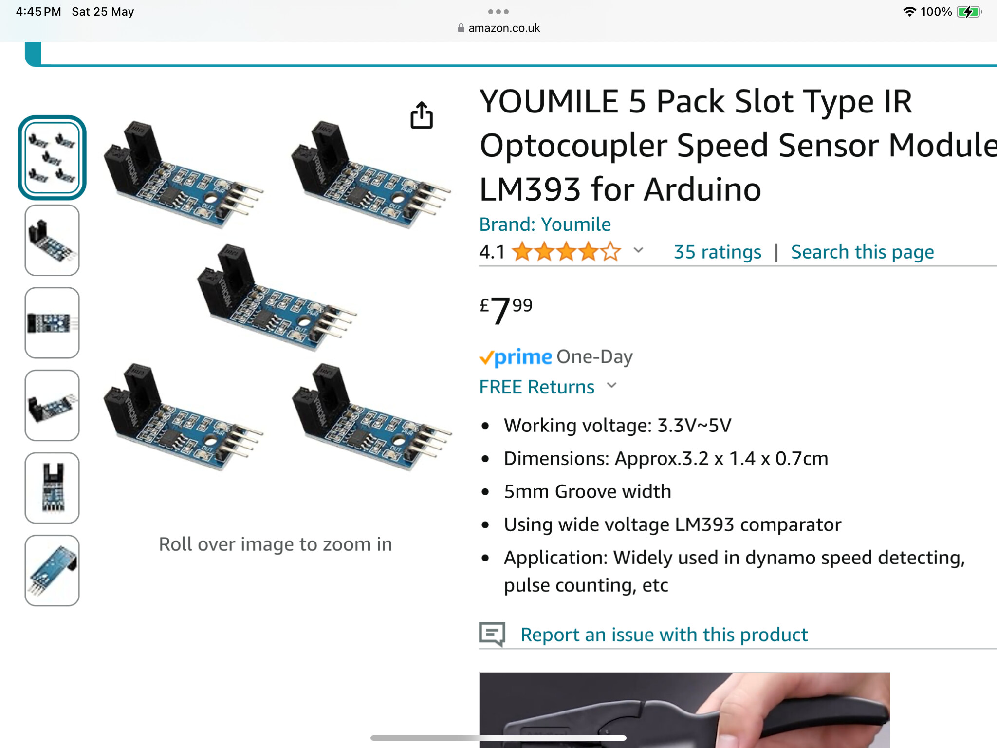

I didn't upload a schematic because I thought my detailed pin allocations covered this. the only other wiring is from vcc to +v and GND to Ground etc.
i have checked all connections and each item several times on the tester board i have created. using very basic sketches for each item and the serial monitor for correct feedback. My tester board just has pins for the connections so i can run breadboard pins to the desired connections. on each component. The components i am using on my tester board are the exact same as the ones stated in the description of what i am trying to create.
i understood the components to be bog standard, run of the mill components. I thought naming the driver board and parts etc would suffice rather than requiring a full information sheet. my apologies here.
As to switches LEDs etc they are just your basic electronic components easily purchased from your local electronics store. nothing special.

I have drawn a rough diagram as requested. Hopefully it all makes sense. Any issues let me know. I will also post some photos of the parts used.
