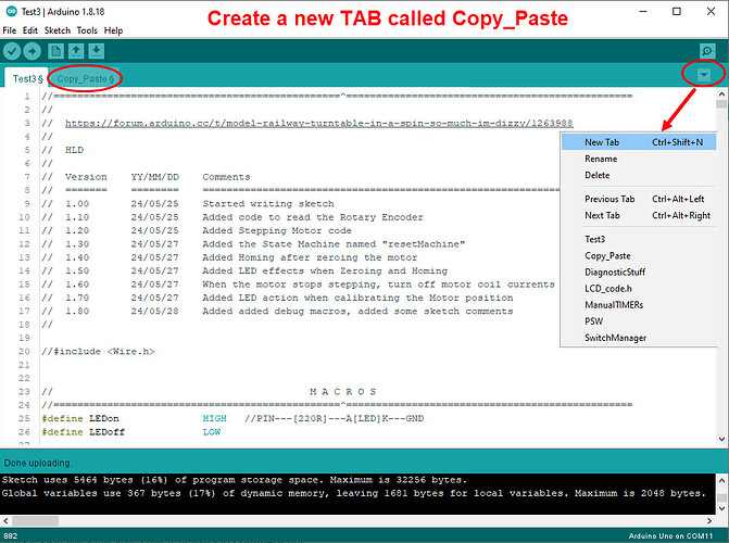

Some programming hints.
Hello Larry.
So in relation to:
I believe i have resolved this one with the code below.
//  https://forum.arduino.cc/t/model-railway-turntable-in-a-spin-so-much-im-dizzy/1263988

//#include <Wire.h>
//                                           M A C R O S
#define LEDon HIGH  //PIN---[220R]---A[LED]K---GND
#define LEDoff LOW
#define PRESSED LOW  //+5V---[Internal 50k]---PIN---[Switch]---GND
#define RELEASED HIGH
#define CLOSED LOW  //+5V---[Internal 50k]---PIN---[Switch]---GND
#define OPENED HIGH
#define OPTOclosed HIGH  //use with "HIGH when closed" opto devices
#define OPTOopened LOW   //use with "LOW when open" opto devices
