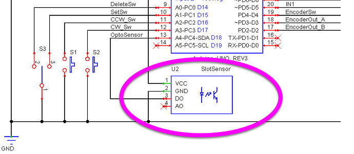

  • Please explain what the code below does ?

  • In the schematic below, D1 and D2 can be controlled by the Arduino.
    D1 turns ON when Arduino pin 8 goes LOW.
    D2 turns ON when Arduino pin 7 goes HIGH.
  • Do you understand why D1 opposite to D2 ?

  • What is the Opto Sensor for ?
That makes sense now. I hadn't seen it written in the shorthand before.
  • Connect the Stepping Motor as shown in the last schematic.
  • Press and hold the CW switch.
  • Release the CW switch and press and hold the CCW switch.
  • What do you observe in the Serial Monitor and what happens with the motor shaft ?

The schematic in post 83 has no opto sensor so i presume we are back to the edited schematic of my own project.
I can see on line 266 that we have made it an input and assigned the correct pin to it.
makeInput OptoSensor =
  18, 0, OPENED, 0                        //pin, switchTime, lastState, counter
So we are setting pin 18, it becomes active as soon as the system powers and its normal state is open i.e. unbroken.
I cannot find anywhere that it actually is told to do anything with the information yet.
This also ring true with my real world setup as nothing occurs and the serial monitor does not record anything either.
  • There is no code section for this yet.
  • What will you be needing this for ?
So pressing the button briefly makes the motor turn a step. Hold it moves multiple steps until released.
I had to check my wiring against the schematic here though as when i pressed the CW button it moved CCW but the serial monitor reported CW.
vice versa with the CCW switch.
I therefore wasn't sure if i had wired them round the wrong way but im pretty sure i have then correct.
The serial monitor reports motor is moving when button is held/pressed and Motor stopped when the button is released.
  • And what do the CW and CCW LEDs do when the CW and CCW switches are closed ?
  • If the CW and CCW LEDs only monitor the CW and CCW switches then wiring the LEDs here would do the same thing, no need to waste two GPIOs.
Sorry. I will need it for setting the zero point on the turntable itself. That way if the previous location isn't saved to the EEPROM then the system can initialise a find zero routine so reestablish/calibrate.
  • To detect the zero position, a simple micro switch would be simpler :thinking:.
my only thinking behind it was that I wanted to leave the LED lit whilst the action of moving to the next stored location was carried out by the motor. I was also hoping to make the led flash or indicate to the user in some way that it was carrying out a half turn routine. and/or flash both together if the zero routine was being carried out.
  • Okay.
I thought that too but ive not been able to find one small enough.
Because the table can turn both ways the switch needs to accept something from both directions that triggers it. i therefore felt i needed one with a wheel on the end of it. rather than the n shape on this one.
But i am open to doing it this way if it would save a lot of time and effort, and prove more reliable/accurate. I can use the ones i bought for testing and then try and locate a smaller one for the real thing.
Like i said before, the size of this scale is extremely limiting and creates problems within itself.
