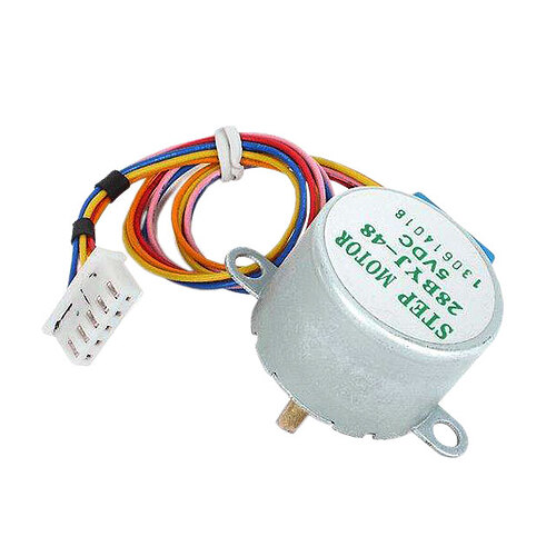

I suppose the next thing is what Stepper motor controller I use.
Those look good. Any thoughts? Looks like there is a library for them at least.

Does that motor have enough torque?

Good point actually. I have estimated I need 1.5Nm, that stepper is only:
In-traction Torque >34.3mN.m(120Hz)
Self-positioning Torque >34.3mN.m
Friction torque 600-1200 gf.cm
Pull in torque 300 gf.cm
