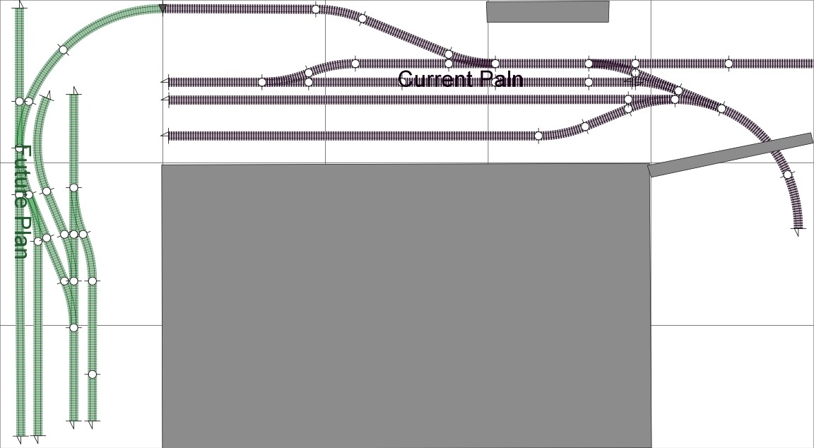

ok We shall start a Fresh guys.
Project
To create a Route Setting system same as in a Modern Signal box
Issue
I have no idea how to start the code.
Concept Explained
every route is controlled by passage of trains and routes defined by the signal man
Routes are defined by the pressing of Buttons, 1 button to start to route and 2nd to define end.
When the route is selected it works out If the track is Occupied If Not it switches the Points to make the route
When the points are in the correct position it releases the Signal to display Green. .
IF a Platform or Siding
It uses a procedure that is Call "CALL ON" this allows the points and signal to control the speed of a train because there is another train on that platform or siding already.
What I have.
I have a way of signal control with a GND and input on the Signal.
Occupicy dector to tell if the track is Free or taken.
Relay to switch the points
Points Motors
What I Need
I have No idea where to start with the code.
Ardunio needs to remember the state of buttons eg needs to remember what button was pressed 1st and then 2nd.
Then it needs to work out what relays it needs to switch on and off Momentary to throw the points.
I was orgnially going to have LCD. This is going to be scrapped for LEDS showing the route I can manage that bit
I am struggling with the base of the code the buttons and switching of points command.
I have got an arduino MEGA in the post but as a Demo I am going to be using a UNO once got the code I shall move on to the Mega to complete the code.
Hope this makes more sense.

Forget about code for a few days. The more thinking and planning you do the easier the code will be when you get to that stage.
It seemed to me that your earlier diagram was just a fragment. If you have a full trackplan and know where all the route selection buttons will go post a copy of it - but keep the size to 1280 x 960 or smaller. If you don't have a full trackplan put together a simple but complete plan that encompasses all the situations you want to allow for.
The purpose of this is so that people here have the same reference "document" as you have. It will make discussion enormously easier.
In parallel with producing the track plan you can be thinking about making a list of all the valid routes.
...R

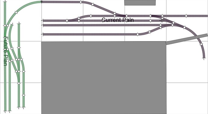

Online Plan
http://thejmr.info/wp-content/uploads/2014/10/StoneHall.jpg
Numbered and Labled
http://thejmr.info/wp-content/uploads/2014/10/bed-room-layout.jpg
Different colours are Different sections.
That diagram represents a lot of progress. However I can't clearly read the numbers - perhaps you do a clearer version.
Also, and perhaps more important, there are a lot of white spots with no numbers.
Maybe your numbers are just identifying the points / turnouts? If so each one will have 2 options.
Can you give me a couple of examples of how you would like to set routes for these moves
  • Clockwise from the future plan all the way round to the fiddleyard non-stop
  • Counter-Clockwise from the fiddle yard to the straight purple section between 3 and 6
And if you give some more examples that would be even better.
...R
Thank you for the reply
For now we will just settle with it switching points for routes.
I have now written on the Plan hopeful either will confuse things or make it clearer.
Each section has a button.
So
If I wanted a train to go from the Fiddle Yard to the Platform 1
I would press the button in the Fiddle Yard and then the one on Platform 1.
Arduino would switch the points and clear the route.
and so on so If I wanted to go from Section 9 to the Fiddle yard.
I would Press the button in Section 9 and then the Fiddle Yard again
Arduino would switch the points and Clear the route.
again
If I wanted to go from the goods line to the headshunt and then to the Fiddle Yard.
I would press the button for the Goods Line and then the head shunt . the points would switch Ill move the train. Once in the headshunt . ill then select the button for the headshunt and then the button for the fiddle yard.The points would switch. ...
Hope this makes it clearer. :slight_smile:

Thanks. That has made things much clearer.
I think if I was doing this project I would now need to write down a list of every route I want to use
For each route I would need the following data
  • all of the train detectors that will enable that route to be confirmed clear
  • the point settings needed
  • the switches needed.
You can probably write them out in a grid - maybe in a spreadsheet.
The purpose of this is so that there can be lists (which will probably go into a 2D array) of the things the Arduino needs to check, and the things it needs to set
