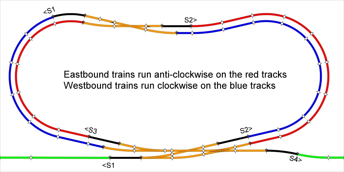

On this model train example, there are 3 pairs of red/blue tracks, where trains can pass or overtake, connected together by 2 single track mainlines. The layout contains 6 red/green signals (S1-S6), 6 un-powered blocking tracks, 8 turnouts (T1-T8), 12 electrically isolated blocks with occupancy detectors (B1-B12). The only requirement is a train must completely fit on a blue or red track.
I will use DCC to control the locomotives. If the trains have engineers with their hands on the throttle, I expect them to stop short of a red signal...and proceed through a green signal. If the trains are running un-attended, I will set them to run at different speeds and let them go. They will all run through a red signal and stop on the un-powered blocking track. A DCC controller talks to the locomotive quite often...so the locomotive will start up after track power is connected to the blocking track.
I assume that the Arduino can read each block detector. align each turnout, set the signals red or green and connect or disconnect track power from the black, blocking tracks. I'm sure some sort of proto shield will be required. The program will loop through all red and blue tracks, looking for a train to move. The table of movement looks something like this. The shorthand description of the first line is
The train on B1 can move to B6, when B3, B5 and B6 or not occupied (open) and the signals S2 and S3 are blocking traffic.
B1 > B6 when B3, B4, B5 and B6 are open and S2 and S3 are red
B2 > B6 when B3, B4, B5 and B6 are open and S1 and S3 are red
B6 > B11 when B8, B9 and B11 are open and S5 and S6 are red
B6 > B12 when B8, B9 and B12 are open and S5 and S6 are red
B11 > B7 when B7, B8, B9 and B10 are open and S5 and S4 are red
B12 > B7 when B7, B8, B9 and B10 are open and S6 and S4 are red
B7 > B1 when B1, B4 and B5 are open and S1 and S2 are red
B7 > B2 when B2, B4 and B5 are open and S1 and S2 are red
When it's time for our train on B1 to move, the turnouts T1, T3 and T4 are aligned, the signal S1 is set green, and track power is connected to the black blocking track. The first time the program looks at B1 and it's not occupied, track power is removed from the black, blocking track and the signal S1 is set red.

I don't understand why I need a bar code. All the decisions are based on the state of just 12 digital inputs (connected to the block occupancy detectors) plus the state of the 8 turnouts and the 6 signals.

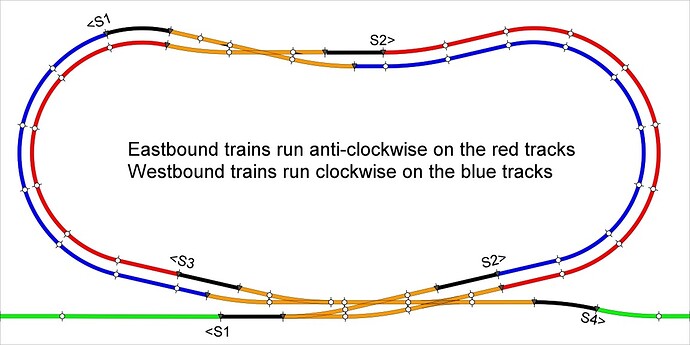

I've attached an image of a more complex middle section with 2 pairs of red/blue sidings, which cross each other. Eastbound and Westbound trains pass each other here.

There are 6 code sections. Each code section is looking for a train on B1, B2, B6, B7, B11, B12. Here is the code section looking for a train on B1. The blocking track associated with B1 is called BT1.
Assume all the signals are red (therefore all the blocking tracks are dead)...and a train will arrive on B1...soon.
IF block B1 is NOT occupied THEN
set S1 red
remove track power from BT1
ELSE IF block B1 IS occupied THEN
IF blocks B3 and B4 and B5 are NOT occupied THEN (the mainline is open)
IF block B6 is NOT occupied THEN (the destination track is open)
IF signals S1 and S2 and S3 ARE red THEN (no trains have permission to use the mainline)
align turnouts T1 and T3 and T4
connect track power to BT1
set signal S1 green (granting permission to use the mainline)
END IF
END IF
END IF
END IF
bhuck:
There are 6 code sections. .......
That seems quite clear.
I presume the signals S1, S2 and S3 will be set by some of the other 6 code sections.
Am I correct to think that a train can only move from one section to the next and cannot run unhindered through 2 or 3 sections (assuming the tracks are available, of course).
Is there a risk of a deadlock where all 6 sections need one of the others to do something? This may be just a theoretical risk unless there are 6 trains moving (or available to move).
What you have proposed should be easy to program in an Arduino. I think I would create some 6 element arrays to hold the section data. If you know how to create and use a struct that would be even neater.

There always has to be an open siding, so this scheme can manage between 1 and 5 trains. Got more trains...add more sidings to a section...or add more sections connected by more mainlines.
BTW, it also works in a circlular layout instead of a point to point layout.
When 1 train is on the layout, it will never be blocked and should never stop.
When 5 trains are on the layout, 4 will be blocked and only 1 will move.
When 2 to 4 trains are on the layout is when it gets exciting.
The code section for B5 and B6 will be a little different. I will randomly choose the destination...if they are both tracks are open.
If both B1 and B2 (also B11 and B12) are occupied, I will randomly pick the train to move first. That should make the race car drivers mad.
And finally, after looking at my code outline, blocks B3, B4 and B5 as well as B8, B9 and B10 can be combined into 2 blocks, named MainlineWest and MainlineEast, Saving the cost of 4 occupancy detectors is always good.
