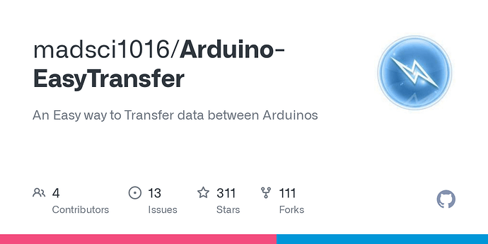

I've found a simple code Here, any idea how to parse those transmit codes into my code?
search term: serial transfer
Thanks, the coding is making my head spin slightly. I might just need to experiment once I receive the modules and can mess around with both modules and boards at the same time. Do you for see any issues using my exiting code and the SerialTransfer?
Wonderful, thank you!
