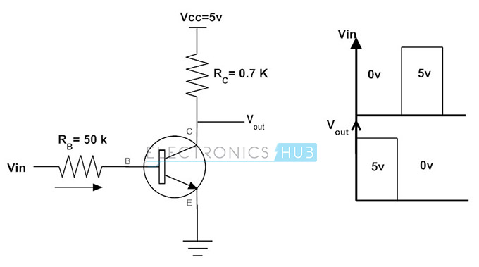

Having done more research, do you think it is possible that this would do the job just as well?
If I connect one LED between Vout and earth and the other between Vout and VCC (with resistors).
If the 'Vin is five volts and a lead is taken from the base, via my switch to earth.
Sorry Mike I think I was just discovering that, what do you think?
Well that circuit is just a logic level inverter, the two signals will just be the inverse of each other so:-

Will have the lights flashing alternately when you are pressing / releasing the button and just one light on when you hold it.
That is basically what I am wanting. I think I was just trying to complicate things.
I will try to build something and see what happens. Thanks.
Since red LED has lower voltage drop than green you can use this:
