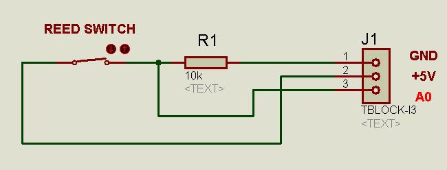

The problem is, every time I connect the arduino's +5V & GND pin to monster moto, the values in the serial monitor are changing.
Please Help. Thanks

@Tom, Here is the schematic diagram of my reed switch. And yes, it is the monster moto shield that I'm saying.

Hi, here is the diagram showing the connection of monster moto, arduino mega and the reed switch.
Is the motor shield wired up using jumpers? or have you fitted it on top of the Arduino?
I've not looked at the shields datasheet but I suspect A0 is used by the shield. It gives the ammount of current drawn by the motor.

Have you got the GND of the boards connected together ,I can't see it in your diagram.

Yes, it is a pin conflict. A0 is one of the enable line outputs. So once you initialize the library, you're no longer reading the reed switch state, you're reading the current enable line state. Worse, when the reed switch closes, you're shorting the line to 5V, which means a huge slug of current into the pin if the output is currently low.
Look at the schematic: MonsterMoto-Shield-v12.pdf
The connections to the Arduino are in the lower left. It uses pins A0 through A3, and D4 through D9. You want to leave D0 and D1 open for the serial port and D13 for the on-board LED. So use D2, D10, D11, D12, or A4 or higher for the reed switch. Since it's a Mega, you have digital pins higher than D13 as well, you can also use any of those.
