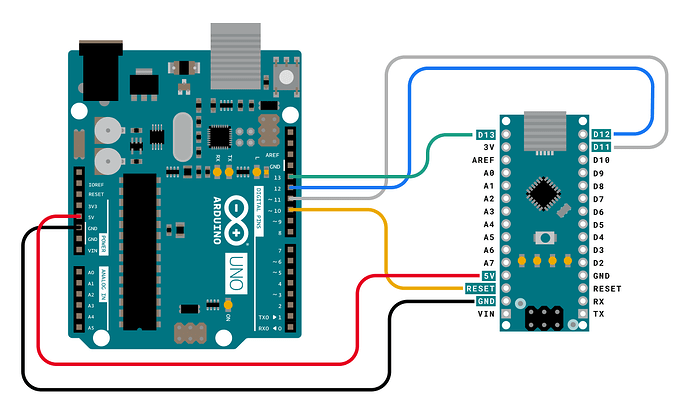

After freshly uploading ArduinoISP to the UNO, I'm adding the 10uF cap between its Reset and Gnd, setting Nano board and port, then Upload Using Programmer.
So I'm at something of a dead end now, after two full days work!
Can I at least force the Nanos to have appropriate bootloaders? Attempts so far result in a similar report to uploading.

Check that there is a common ground between your Nano and the Uno that you are using as an ISP programmer. That could explain this erratic behaviour. If that is not the problem, please add a picture of your set up.
I think the "genuine Uno" thing goes back to the Nano bootloader change. When Arduino changed the Nano bootloader, it neglected to change the fuse that sets how much flash memory is allocted to the bootloader. So it remained 2K even though the new bootloader fits in 512 bytes. Some people wanted to reclaim that memory but keep the new bootloader. The easy way to do that was to just reflash the bootloader and fuses specifiying the device as an "Uno", which has the new bootloader stored in 512 bytes.
I have found that the capacitor on the reset pin of the programming Arduino (not the target) is essential. But I'm still using v1.8.8 of the IDE. I don't know if it's needed in V2xx.

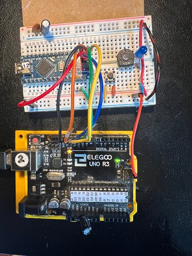

attached. Taken shortly after changing from the tidier wiring shown at the top. I wanted to check the cause was not loose connection(s) in the ICSP block I've always used.
Ignore LED, preset and N/O button also on breadboard.
EDIT
Behaviour identical with temporary rewiring so reverted to my tidier version:

Is that a capacitor between Vin and Reset on the Nano ? I don't think that should be there.
What is the purpose of the push button ? It appears to short the power rails.
I can't check the ICSP header wiring but I guess you've checked it often enough.

Thanks for the reply.
That addition of a small cap was based on this tip from Nick Gammon. Although I was (still am) unclear why Vin to Gnd and not 5V to Gnd. Tried both. Now removed.
"Tip
If you are programming your own board, or using a breadboard, then decoupling capacitors are required! Decoupling capacitors are typically ceramic capacitors, 0.1 ยตF (100 nF) between Vcc and Gnd (and also AVcc and Gnd if applicable), close to the chip.
If you don't use them you may find that the chip is recognized, but cannot be programmed. They are not an optional extra.
If you are just programming one Arduino board from another, then they will already have decoupling capacitors on the board, so you don't need to worry about them."

I'm confused. The capacitor is supposed to be between the reset pin and ground of the programming device - the Uno in this case.
Well, you did have the new Nano working for a while, so there probably is a way to get back to that state. If you have an older Nano that works fine, I think one approach at this point would be to use the Uno as ISP to flash the Blink example to that Nano, just to be sure you're doing everything right, and you're working with a known good part. Then you could just drop in the new Nano and do the same same thing, or perhaps also flash the bootloader.
As I understand it, Nick is recommending a small ceramic decoupling capacitor between the +ve and ground lines. I think you are referrring to the electrolytic cap, typically 10uF.
The latter has certainly been one cause of my problems; with dozens of test runs, remembering whether to have it in place (for uploading to the Nano via ISP), and removing it when the ISP sketch need re-uploading to the Uno!
He specified Vin, but I would have thought 5V? The former is at 4.47V here, the latter at 4.87V.
This is how to connect the boards. No capacitor, no breadboard.
Is there anyone here who has done this successfully without the reset capacitor? If so, what version of the IDE did you use? I use v1.8.8, and for me the capacitor is necessary.
Yes I have. But I did it by placing a miniature slide switch to disconnect the reset signal from the auto reset circuit. Works every time.
No that is wrong. because then the capacitor would be on the other side of the regulator chip. Sure put one there as well, but it does more good where he said to put it.
