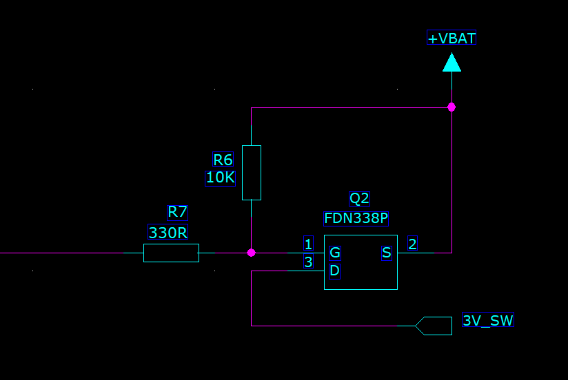

I am looking at the "Temperature and humidity sensor - battery powered" project by Nick Gammon.
I would like to build this project using 3.6V LiSocal2 battery and suface mount components.
I have conducted a couple of tests with the MOSFET switching and am not able to get it to work.
I have tried both FDN338P and FDV304P which are P-Channel Digital devices.
In the attached schematic, +VBAT is 3.6V.
The 330R (R7) is driven from the Arduino D7.
D7 is configured as a Output, with default HIGH. "digitalWrite (POWER, LOW); // turn power ON"
I am not a hardware specialist and would appreciate someone with the knowledge to review my design.
