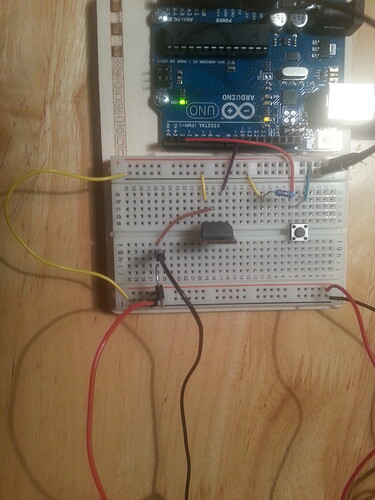

I'm using the arduino uno starter kit. I set up the circuit shown in project 9 of the starter kit, the motorised pinwheel. Which works fine, my problem is that I attempted to modify the circuit by using the battery and motor from an old electric screwdriver, which is a 3.6v motor powered by essentially 3 AA batteries. Reason for this being that I want to combine the knock knock lock and the motor and gearbox from the screwdriver to open a door on my TV stand.
My problem is that when all hooked up, the mosfet gets hot after 10 - 15 seconds and the motor does not turn, only vibrates (or that's what it feels like)

Here's some pictures it might help.....
A PP3 9V battery is a very low current power source so presumably the motor designed to work with it only draws a tiny current. A bigger motor would draw more current, and a lower voltage motor would also typically draw more current (for the equivalent power). It may be that the motor is simply trying to draw more current than your MOSFET can provide.
Have you calculated / looked up the current needed to turn the motor, and compared that to the spec of the MOSFET?

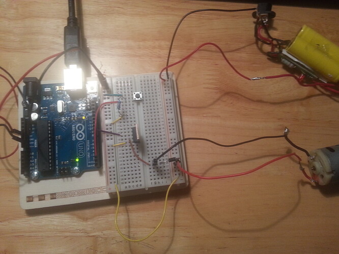

The battery and motor are taken from an electric screwdriver. To me the battery looks like three AAs but it might not be, there's a picture above of them. I've tried connecting the motor directly to the battery and it works fine. Could this mean the info I have on the motor is wrong?
The motor looks fine, I've used many of those in the past, but that battery does look a little too small to supply the necessary current needed for this to work correctly. Try to get a 9V, and see if it makes a difference. If anything, you will rule out the power source and if that still doesn't solve the problem, then it could just be a bad Mosfet.

Hi, change the layout on the protoboard, where you have the 3.3V battery connected is a long way from the motor through small conductors.
Move the positive battery connection up to next to the positive motor wire, and the negative battery to the source lead of the MOSFET. This way you minimize the length of fine gauge conductors under the board.
