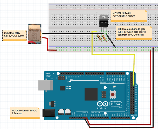

Hey,
I am experiencing some problems controlling an industrial relay with my Arduino, although I have done a lot of research. When I power the system, the 68 Ohm resistor gets so hot i can barely hold a finger at it. First I thought I was sending way to much power trough it, so I brought a larger one that can handle 2 watts, but its still getting hot. In my calculations it should be about 1.1w going trough.
The circuit is shown in the attached photo.
Thanks in advance.
WHY on earth do you have the 68 ohm resistor between MOSFET and GND? It makes absolutely no sense.
Also, your contactor is connected between GND and MOSFET switching to ground - it will never receive power.
Right now, the MOSFET is dumping power into the resistor, the contactor gets no voltage at all.
Rethink your schematic - it's all wrong.
// Per.

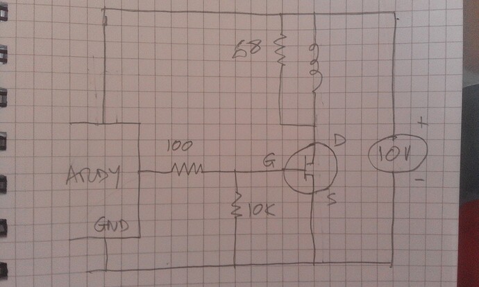

I have used this schematic before just with less current, working totally fine.
Something is obviously wrong, but the relay/contactor is receiving power. Only when the relay is off the resistor is getting hot.
The 68 ohm resistor is between MOSFET and 10VDC.

I read it that the 68R is across the relay, which is to all intents and purposes a short of 10V to ground through the closed mosfet.
Did you mean the 68R to be a flyback diode? You do need one, and it would go where that resistor is.

No, it is not working fine.
First off, you are trying to power the contactor trough the Arduino's diode on the input - a big NO-NO. Power it directly.
Second, your contactor is connected between GND and GND - it will NEVER receive power.
Thirsd, your 68 ohm resistor IS connected from VCC to GND trough the MOSFET - it WILL be hot - There is NO reason to have this 68 ohm resistor there.
Please post a picture of how you ACTUALLY connected it - your schematic is NOT how you did it, if your contactor receives power at any point in time.

Why don't you post a schematic of the circuit? Is my interpretation as in #4 correct?
If so, what's the 68R across the relay for. Lose it and stick a reverse biased diode in as flyback protection.
Your circuit should look like this. No resistor across the relay.
Such a resistor could possibly make sense because it might cause faster switchoff than a diode. In that case, however, it should be done by someone who remotely knows what he is doing and it should be appropriately dimensioned.

What is this industrial relay? How much voltage/current does the coil require?
The original attachment has the 68R in SERIES with the relay, actually it is acting as a current limiting resistor because the relay is hooked up kind of wrong. With the mosfet OFF, the relay coil pulls all it's current through the 68R. With the mosfet conducting, it drops the voltage to the relay coil, and the 68R carries the current through the mosfet AND relay.
Best I can say is to get the relay coil in series between Vss and mosfet drain, with the source directly to ground. Lose the 68R, and go with a diode in PARALLEL with the coil. The gate resistors are fine.

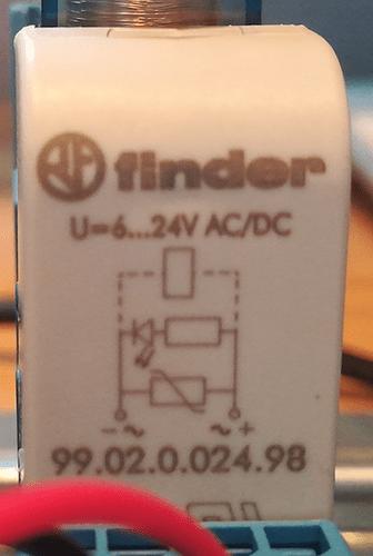

The relay-coil is rated at 12VDC 500mW, it requires 8VDC at minimum to turn active.
I have a diode module attached to the relay (picture as attachment).
Is the rewired circuit and the diode attachment, okay now?
No!!
Do it like post 8.
Allan
Yes, circuit is ok now.

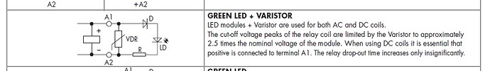

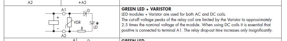

That relay seems to have a buildin snubber circuit (varistor), and an indicator LED.
No external diode across the relay coil needed.
Leo..

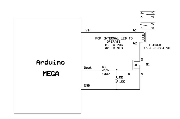

You need to learn to draw schematics of your circuits, not use fritzy pictures.
A schematic like this is easier to read and analyse.
Also your relay needs to be connected A1 to positive and A2 to negative as in this schematic.
Tom... :slight_smile:
