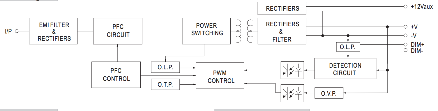

Well how much current does it TAKE, not NEED?
(An optocoupler doesn't need a lot of current, but that doesn't keep it from frying if you just connect it to 5V)
Thats the problem I cant find it in the datasheet..
It has over-voltage,over-heating and short circuit protection.
Do you think it will be okay without a resistor added?
Put a resistor and measure the voltage over the resistor. If it is essentially 0V, then the input is high impedance, if it is not 0V, then you can calculate the current and the resistance of the input.

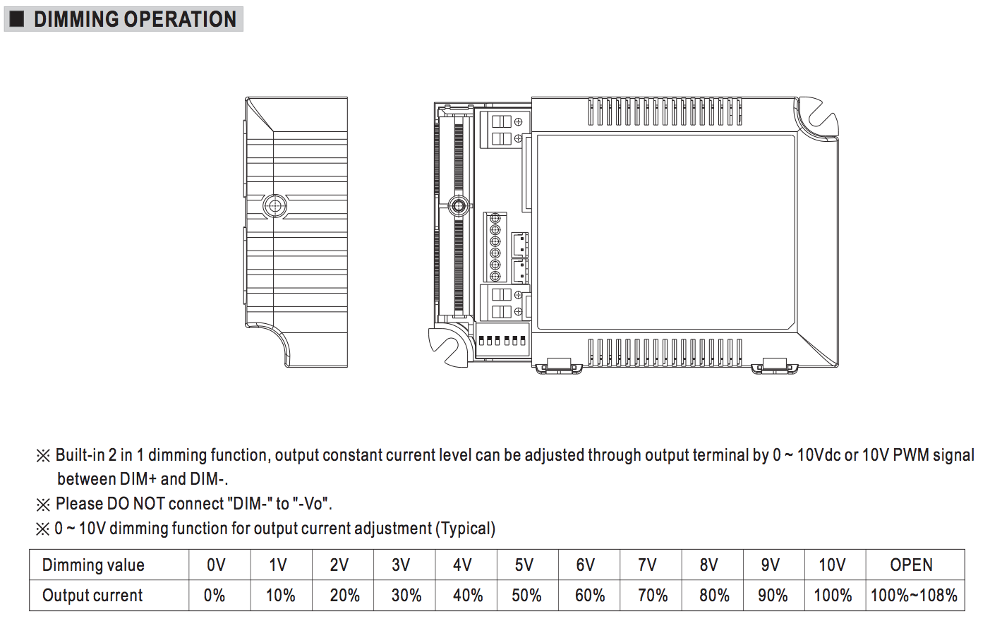

Are you trying to turn a Meanwell LED driver off by switching (shorting) the DIM pins with a relay?
The datasheet states 10volt and 100k. A current of ~100uA.

Ahh, got you now. Mains power switching with that relay is ok.
Yes, coil whine (buzzing) of switching supplies can be audible, and depending on the dim/off level.
The DIM inputs can AFAIK be controlled with a 100k pot (100k being full brightness, and 0k being off).
Or with a voltage (0-10volt).
Or with a (PWM) switch (transistor or opto transistor).
No diodes needed there, because you're just sinking a small current.
Leo..

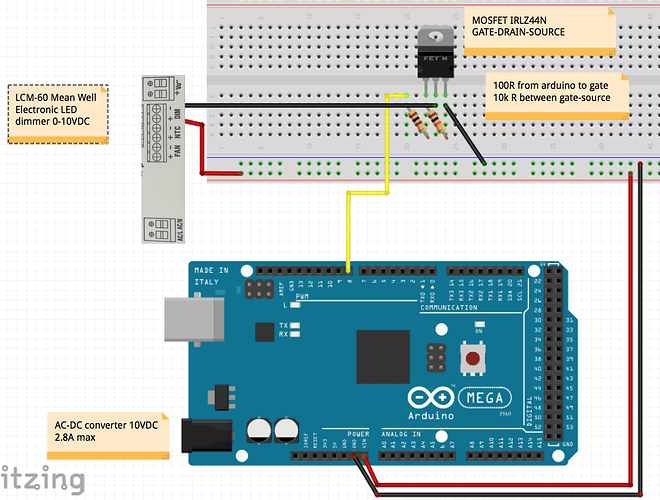

I tried the new MOSFET setup now, without luck. It worked fine with my old setup, discussed earlier.
Now the lights just stays on...
Does anyone know why this is happening?
The OLD circuit is almost right, the new one is not.
DIM(-) should go to Arduino ground and fet source.
DIM(+) to drain.
NO supply (V-in) to the breadboard.
100-220ohm resistor from Arduino signal pin to gate.
10k resistor from Arduino signal pin to Arduino ground.
You could just use a small signal transistor (BC547 etc) with 1k base resistor for all of this.
Leo..
Thanks Leo!
Now it works like a dream. Sorry to bother you so much with this with this.

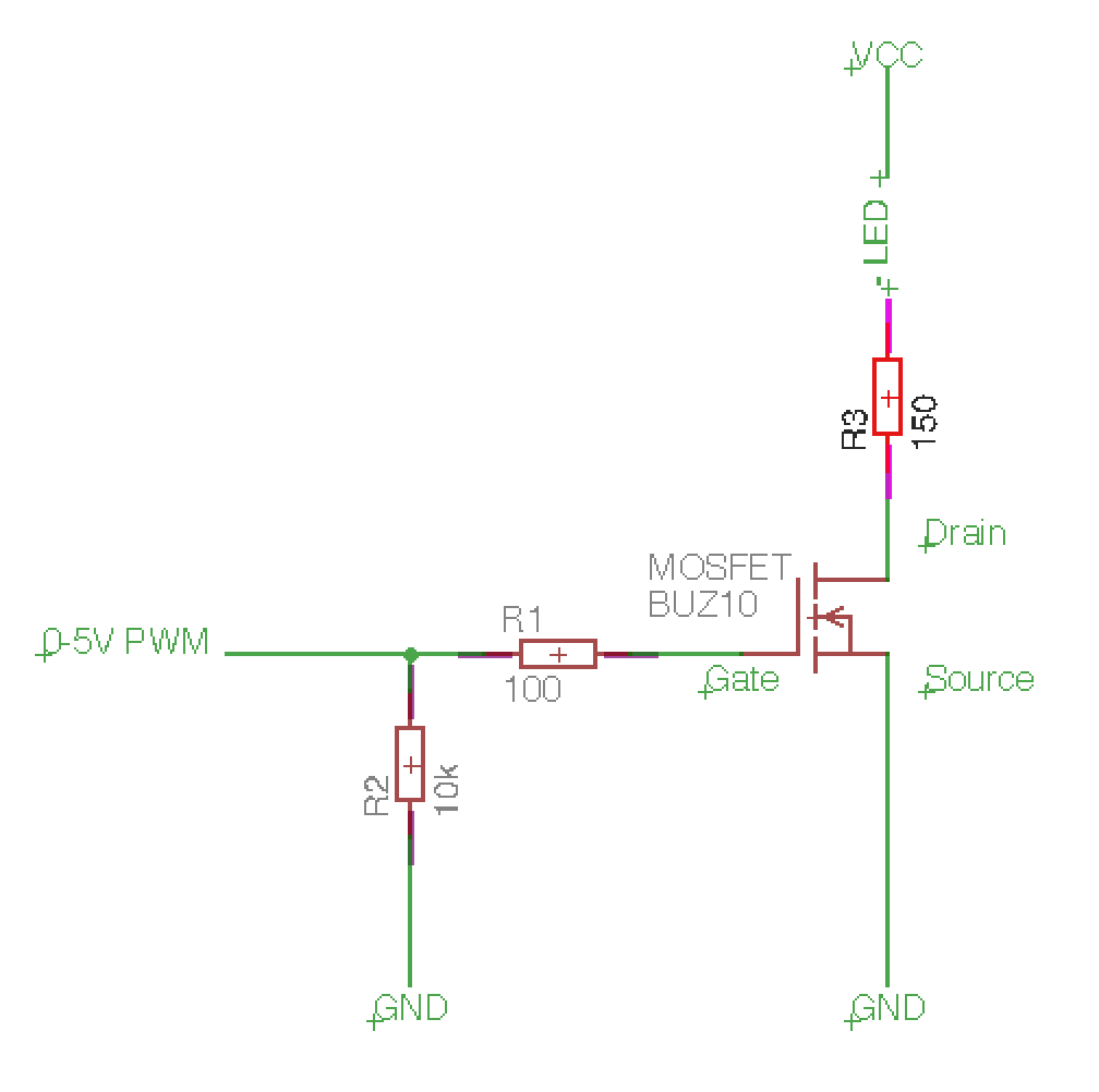

One final question about using transistors. I dont quite get it... What is actually reducing the flow of electrons in this circuits? As an example I have uploaded a schematic on using a MOSFET to dim a high power LED. I will need a resistor, right? When should I use a diode in such a circuit?
Thanks!
Sumitsubo:
Where? In the light circuit the LED, the resistor and to a small extend the R_DS(on) of the MOSFET.
The gate of a MOSFET is only a capacitor. After it is filled, it does not conduct anymore. To avoid large currents from the Arduino pin while charging, R1 is in place.
If the MOSFET was a BJT instead, the base (MOSFET: gate) would be connected to the emitter (MOSFET: source) and R1 would limit the current. Since it would flow continuously, 100Ohm would not be enough.
