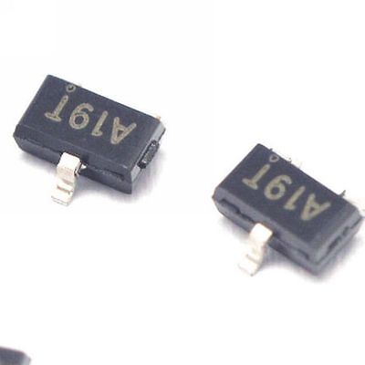

Ordered these transistors and mosfets. Should be ok for powering a standalone Atmega328p at 3.3v?
