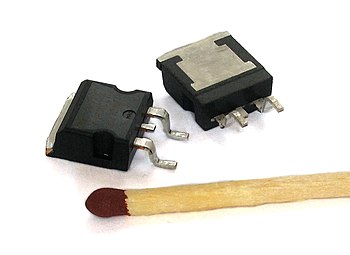

Now I use N-Channel Logic Level MOSFET for most switching applications, particularly my power LED applications, where I am switching amperes at times.
Here's the ones that I have been using:
http://www.ebay.com/itm/160768659447
They are rated for 60v 11A. For twenty cents a pop. Love them. Just make sure to look for "Logic Level" in the name of the component, these are ones that will be (mostly) switched on by 5v, rather than the usual 10-12v at the gate terminal.
