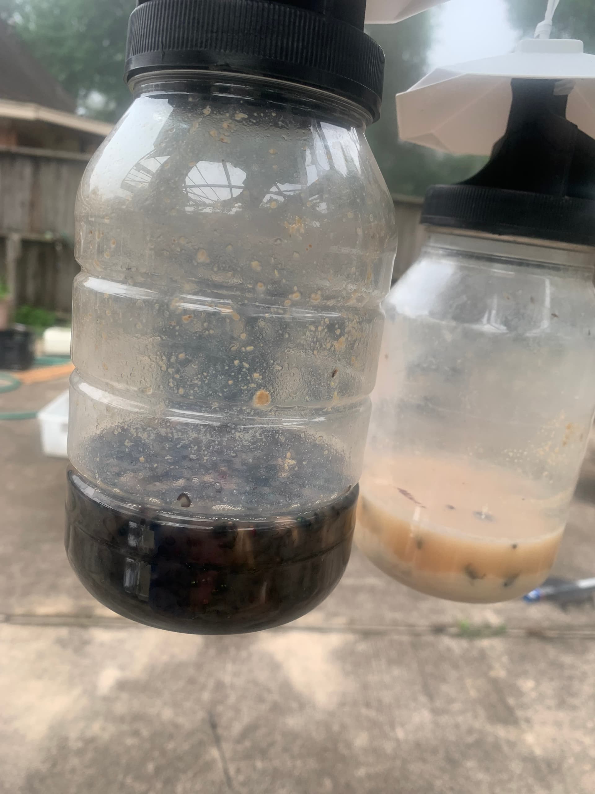

My experimental setting for outdoor in the backyard and front yard as control
Using fly magnet fly AMAZON'S traps at front yard and backyard. The picture shows R,G,B but our brain mic them up to appear as 'white' to human's eyes.
And the result after 2 weeks The trap in frontward (control) contains carcasses of thousands of flies and only few in the backyard where ight was installed.

The size of our backyard only allows us to test the effective radius of the light up to 30 feet.
It Works. Throughout
Interesting - have you double checked how many flies you get with the light off ? Or with a steady white light ? That will show you the improvement gained
the picture shows the trap in front yard (without the light)., other side of the house I caught 100s daily. With the light OFF in the cases of power outage They comes every where.

BTW: Backyard is where out trash, trash cans are.
It's look steady white to human , in the uploaded picture show as such because we fix the code to emit only white in order to show how its looked without it, I could not take the "white" pictures or video on my Iphone , the images it took in frozen moment which is either R or G or B. (in my earlier pic.)
The "WHIE" light does not repel.
