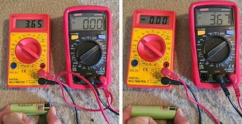

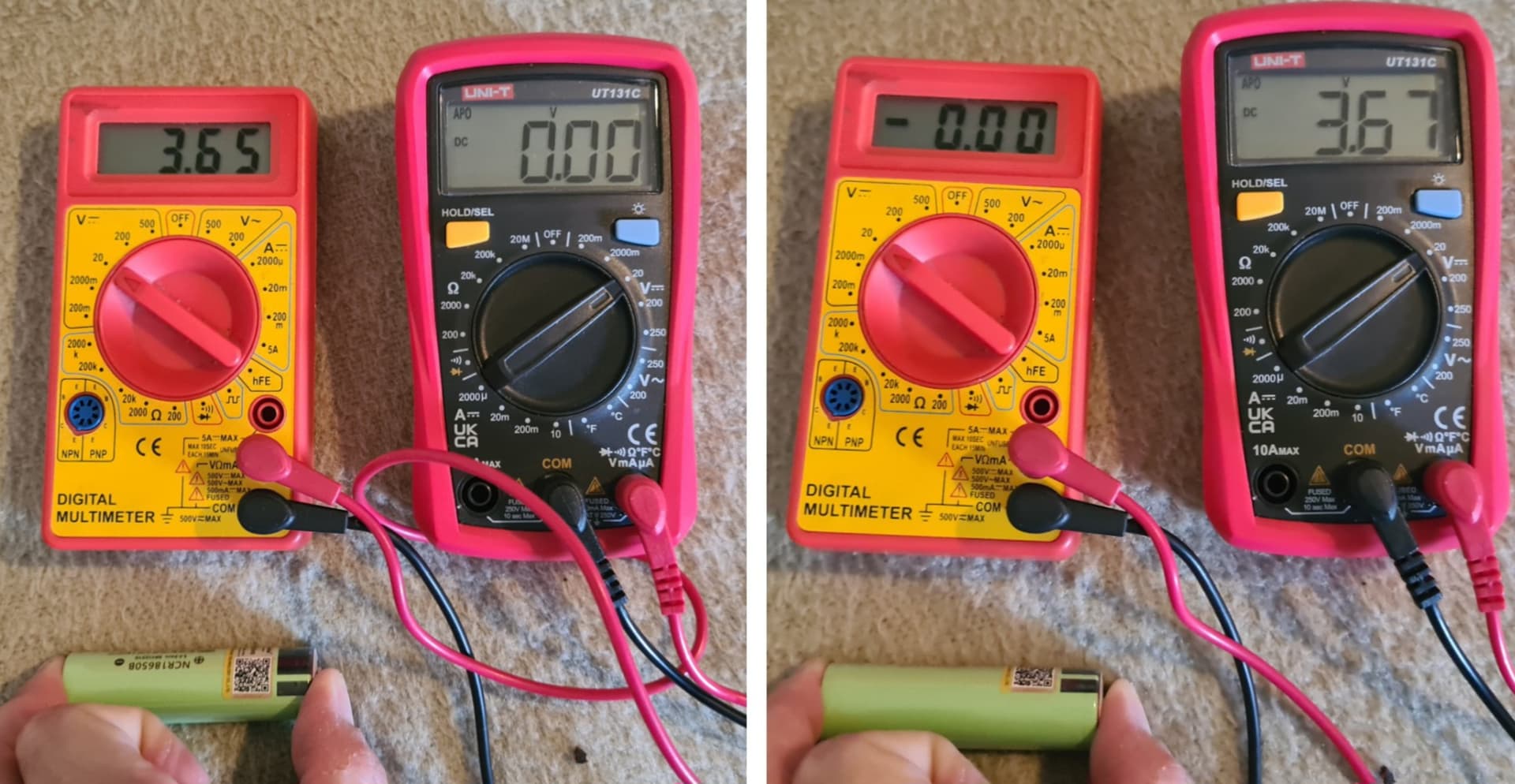

If you track my last threads, you can find that I bought a new and good multimeter.
I made a picture of the old and new multimeter measurements to prove it to you. If you do not believe I have a third multimeter and a few quick voltage meters and can measure with that.
This picture is of my replaced battery, but overcharged with this lamp 4.57v.
Also, the lamp overcharges the 800mAh battery, which came with the lamp.
My regular home charger never passes 4.20v on those mine Liitokala batteries.

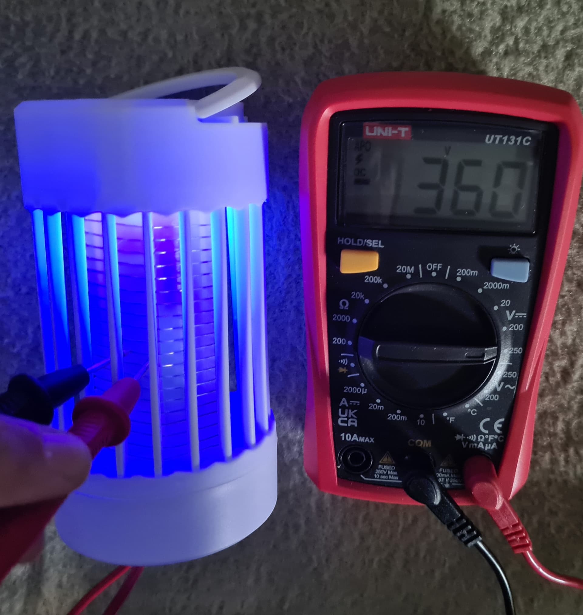

That all similar lamps are described like 1000-3000 volts. Why is that? Is that because "mosquito fill" 3000 volts on itself?
And why my multimeter show 360 volts then, when touch two wires (mosquito kill), but it is not really that much, because I can touch it with fingers (someone touch with tongue I saw). And I know how strong is real 12v on electric fence energiser, it's really hurt.
Picture show of touching two wires which kill the bugs. Voltage says 360. Is that maybe something to do with AC / DC current?
I suggest you not to use your multimeter to measure kV range voltages.
And I wasn't kidding about the safety of your batteries. At 4.57V they are overcharged ~110% and not safe to use.
You meter is loading down the circuit and I'm sure it's not a constant 3000V but pulsed so your meter can't read it

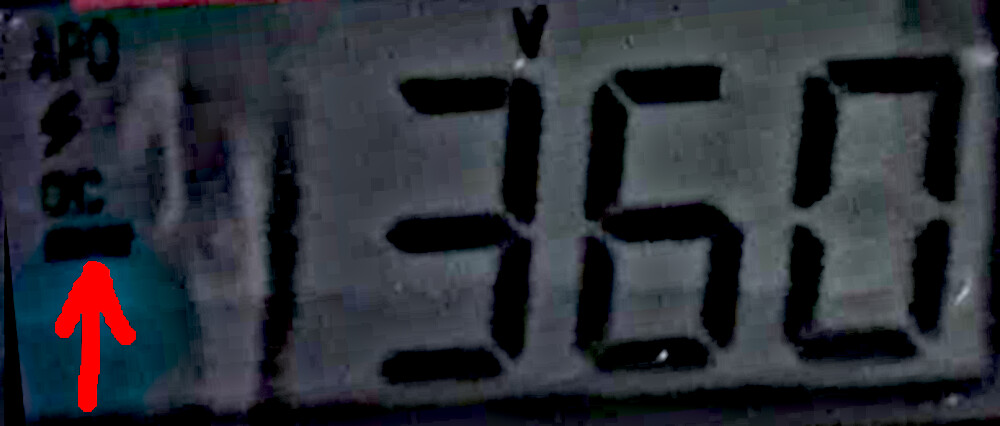

You are using the 250vdc range to measure 3kvdc and the reading is negative 360vdc. ("APO" indicates auto-power-off is enabled)

I'd already noticed from the second photograph in post #4 that danyCro doesn't care which way he connects the probes: -4.57V indicated.
That is a good idea! I will send a pictures.
Yes, because always show the same, positive or negative.

Do you want to destroy your multimeter???
Nice try!
it is definitely not made for kV range!
