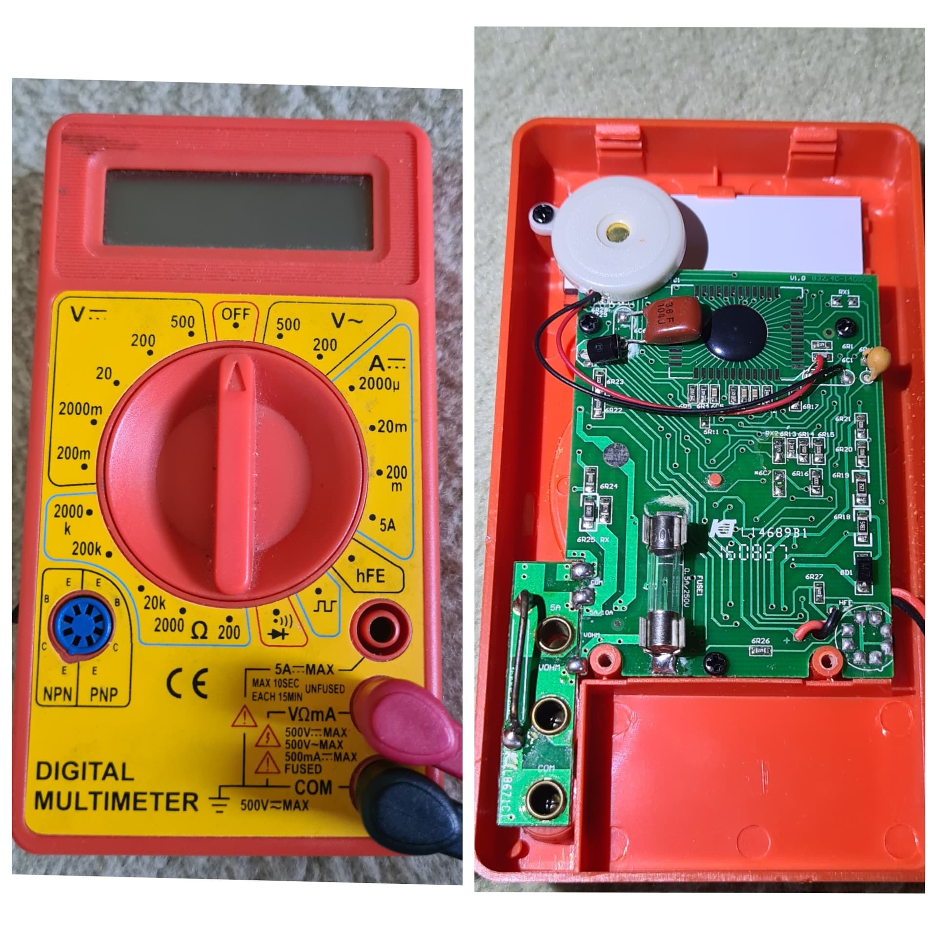

I tried with my secondary multimeter of 500v. Lamp show 273 volts temporary.
But can someone tell me why my recket cant measure voltage? I always got a spark with probes of multimeter.

Hi, @danyCro
You got a spark because CURRENT flowed through your multimeter, your DMM has resistance so any voltage applied to it will cause a CURRENT to flow.
When you applied a higher voltage than the DMM was designed for the CURRENT flowing through the DMM and the VOLTAGE across it destroyed many of the components in the DMM.

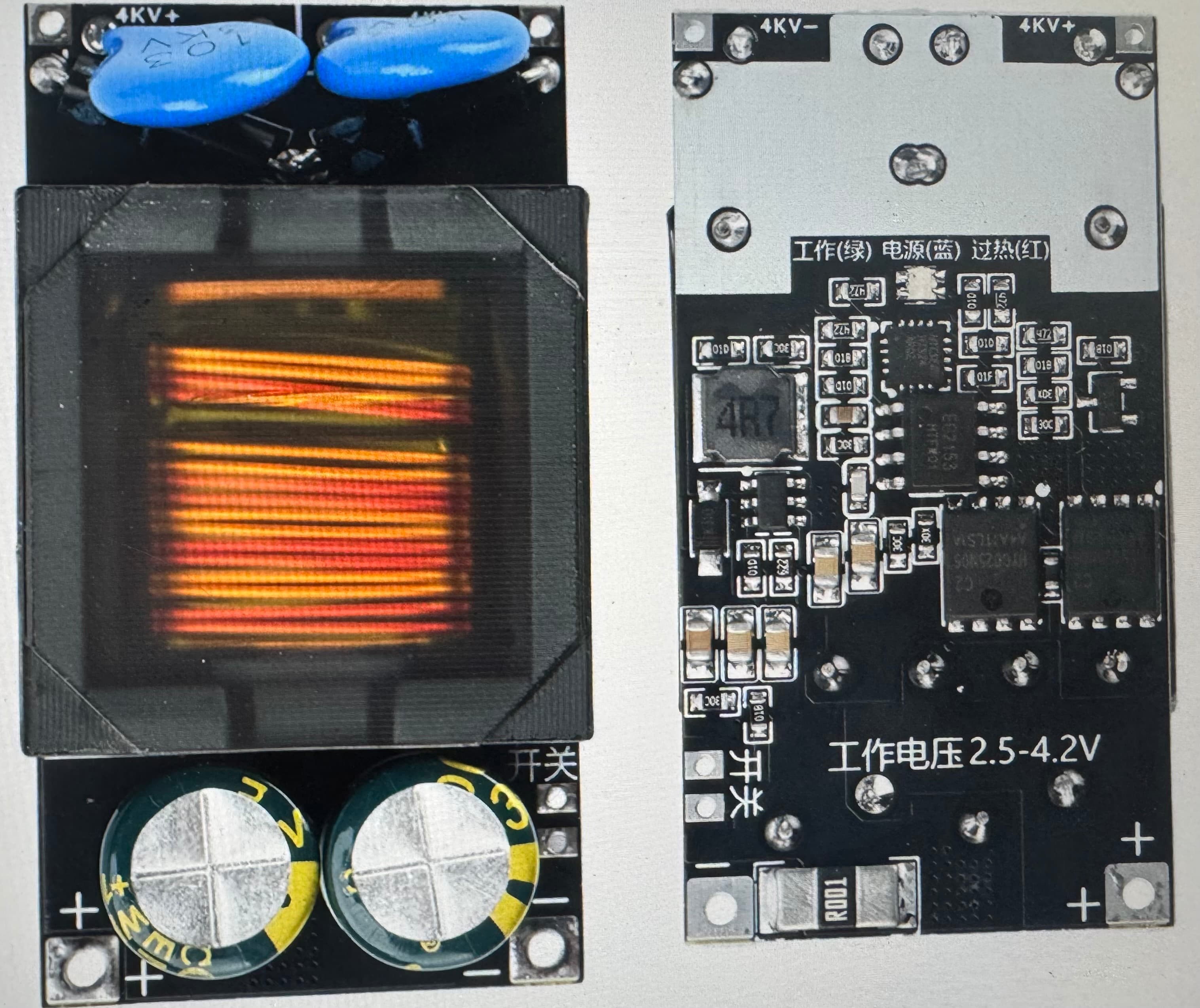

You could make a voltage divider using high resistance/high voltage resistors and have a snowballs chance of getting a meaningful reading without damaging your voltmeter.
Maybe your electronics looks something like this inside.
In fact, if your DMM has the typical 10 megohm input resistance you could make a fairly usable voltage dividers out of capacitors. Some through hole ceramic capacitors used by hobbyists have a working voltage of 1kV. You could put 4 of those in series and make a voltage divider that would tolerate your 3-4 kV. You calculate the division just like series resistors. The value is not stable while charging or with very much current draw but maybe good enough with 10 megohm input resistance DMM.
I use this multimeter to test 500v 5A. See the PCB. There can't be installed those big capacitors?
I chose that one because black one don't have fuse, and newest UNI-T multimeter I don't want destroy.
Maybe you misunderstood. The images in Post #55 are of the inside of your tennis racket zapper. If you can expose the circuit board maybe you can safely measure the high voltage.
The voltage divider I am suggesting you build would be one like you would build to reduce the signal voltage to an Arduino for safe measurement except you would have to use components rated for the very high voltage you are dealing with.
There is no need to open up your DMM as the voltage divider would just be lying on your test bench and could easily be touched with your meter probes.
