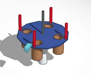

The idea between this is that i want to make a machine like this:
So i'll explain there is a circle platform(in dark blue) witch is paste to the top of the motor ( the white objet) all i want to make it rotate, turn the platform with motor.
But i want the motor to make 90° rotation...
So the sensor ( the blue one) will detect the red box and make a signal.
The red box are placed in the corner of the platform, next to the little circle, just to symbolize the 90° degry of the retation.
All i want is to the beggining, the motor is already on, the motor turn but when the sensor detect something (it's mean the red box) it will make the motor off, stop rotate.
Of course if nothing is detected yet, the motor will still rotate.

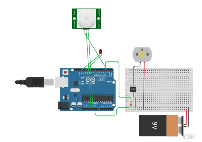

Here the image of the circuit, i have to tell that the circuit and also the code are combination of other circuit, code.

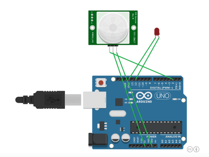

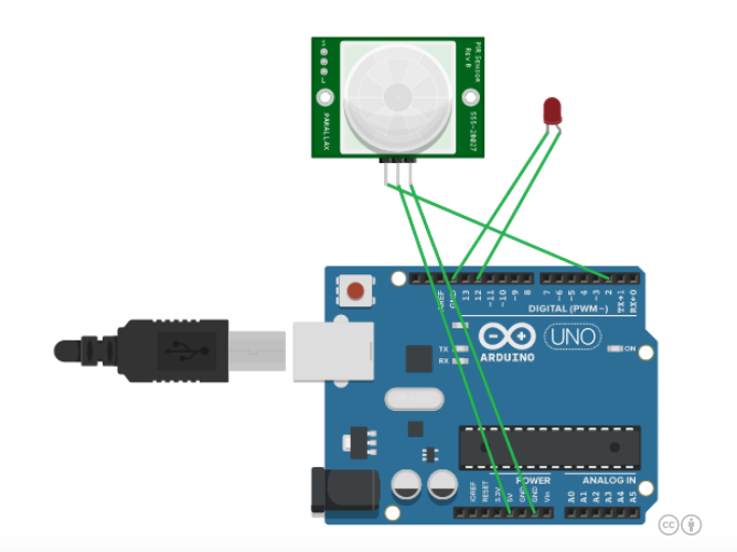

For the circuit, here are the models of circuit that I have used:
For the sensor:
For the motor:
And here my circuit:

for the sensor:
const int buttonPin = 2; // broche du capteur PIR
const int ledPin = 12; // la LED du Arduino
int buttonState = 0; // etat de la sortie du capteur
  pinMode(ledPin, OUTPUT); //la broche de la LED est mise en sortie
  pinMode(buttonPin, INPUT); //la broche du capteur est mise en entree
  buttonState = digitalRead(buttonPin);//lecture du capteur
  if (buttonState == HIGH) //si quelquechose est detecte
    digitalWrite(ledPin, HIGH); //on allume la LED
  else //sinon
    digitalWrite(ledPin, LOW); //on eteint la LED

Here that all, however the final code ( the last one ) doesn't work properly, it does make the motor on but the detection of the sensor doesn't make the motor stop rotate...
Can you help me out?

I am assuming the code is what is in your Original Post. This is the code from loop()
 for (int i = 0; i = 50; i++) // we turn the motor
   analogWrite(3, i);
   delay(10);
 buttonState = digitalRead(buttonPin);// reading of the sensor
 if (buttonState == HIGH) // if something is detected
   digitalWrite(ledPin, HIGH); // LED on
   for (int i = 50; i = 0; i++) // We stop the rotation of the motor
   analogWrite(3, i);
   delay(10);
I suspect the main problem with that is your use of FOR because all the code in a FOR loop will complete before anything else happens. So, for example the speed of the motor increases in 50 steps over a period of 500 millisecs before there is any attempt to read the sensor. And then if the sensor is detected there will be another 50 steps ...
And as well as that you have the syntax for your FOR loops wrong. The first one should be
for (int i = 0; i <= 50; i++) // we turn the motor
and the second one should be
for (int i = 50; i >= 0; i--) // We stop the rotation of the motor
However I have no idea how far the motor will move in 500 millisecs
And what do you think will happen if the sensor is not detected the first time?
