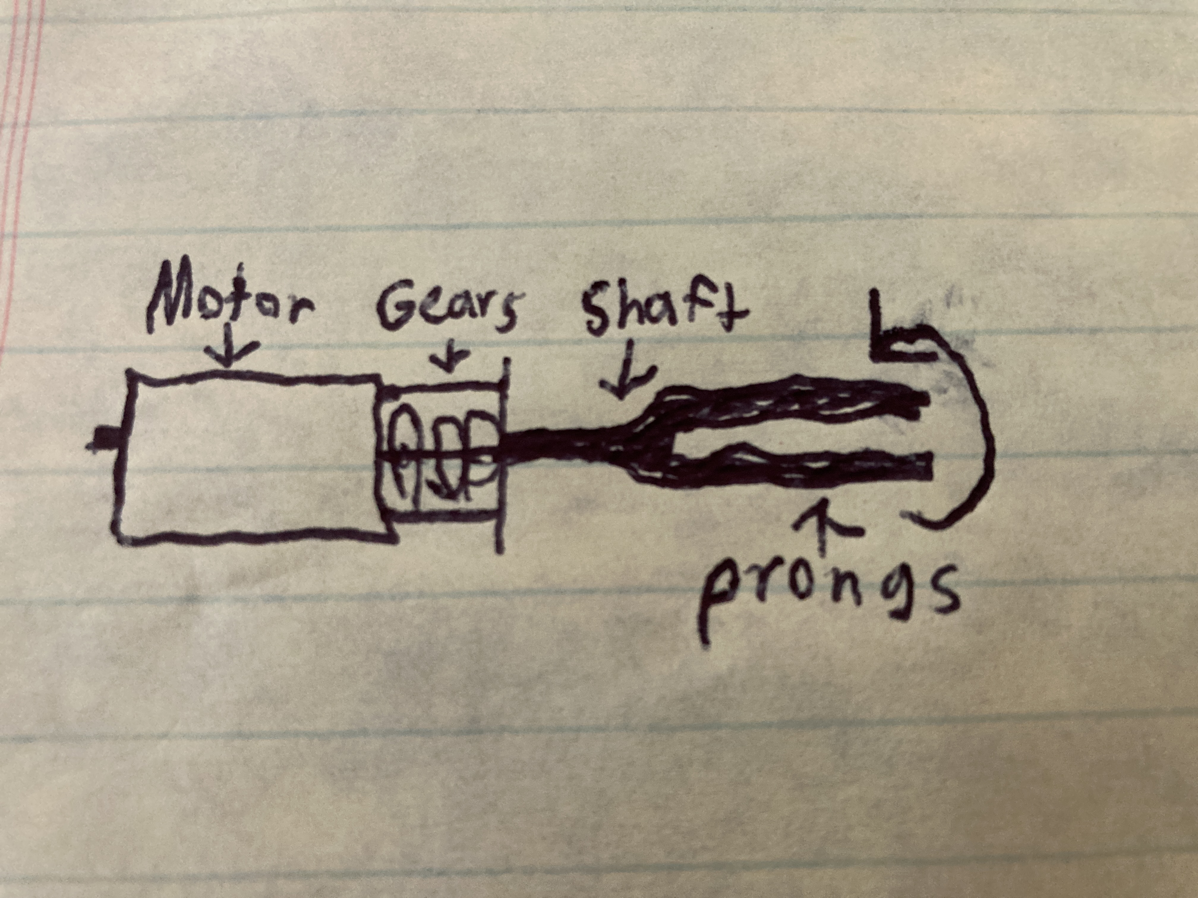

If we knew more about your project, maybe we could suggest something simpler. Can you post a simple drawing of your apparatus?
Here is a drawing of the motor and shaft, the shaft with the prongs will spin for a few rotations then stop, and spin backwards for a rotation, then it will search for the home position.

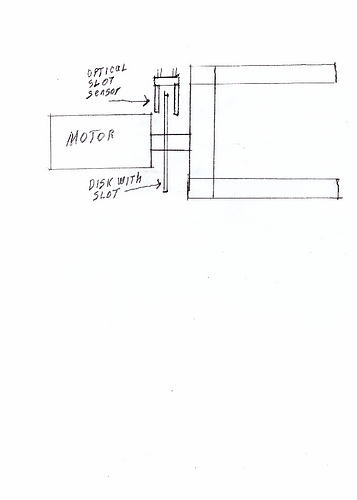

Could you use a slotted disk and optical slot sensor something like this?
Thank you, I was also recommended to do it this way in the arduino discord and I think it is going to work the best! Also nice drawing.
