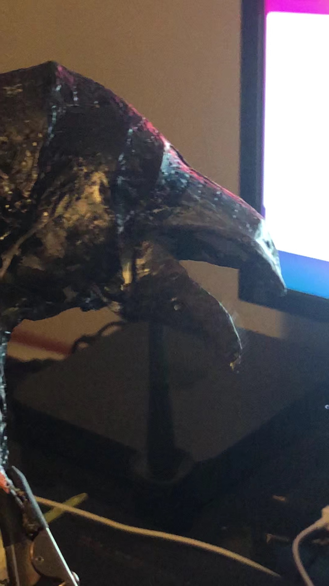

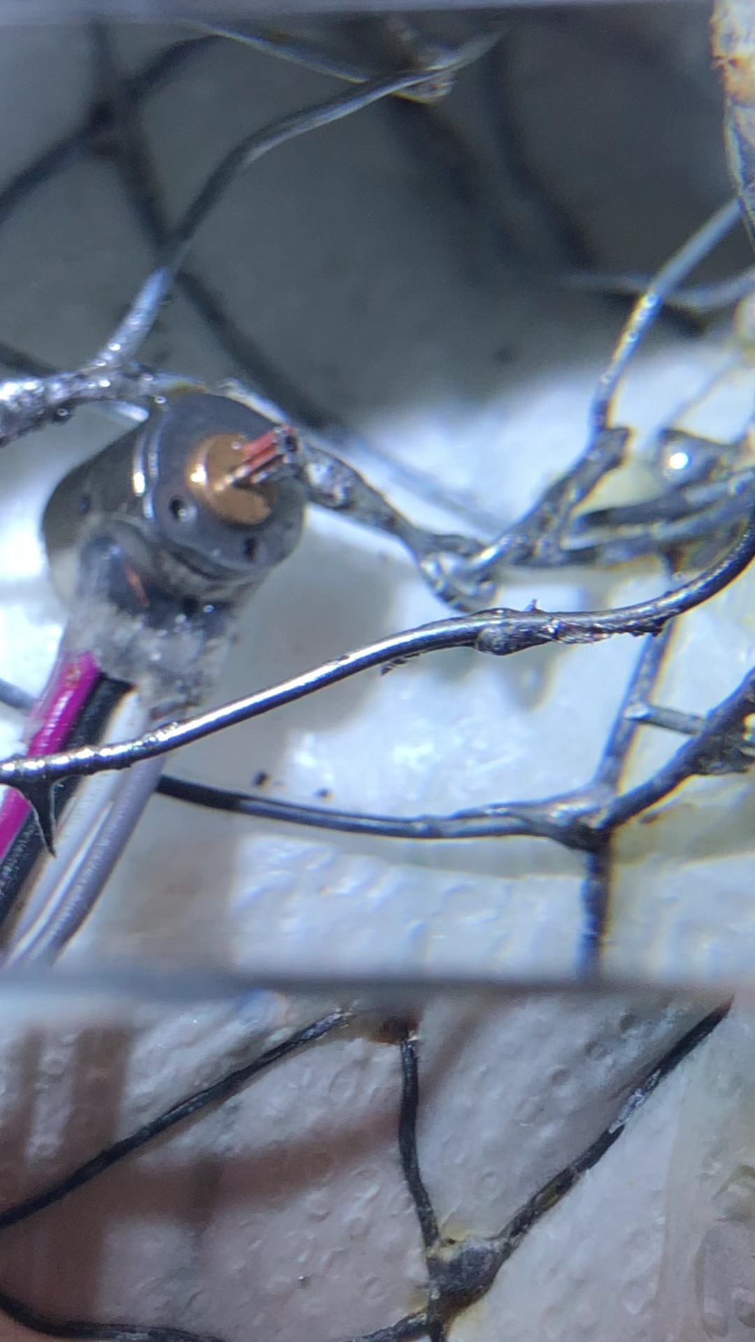

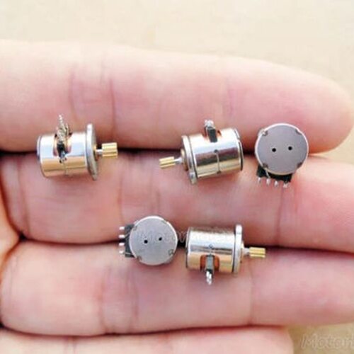

new mini/micro stepper motors from Ali Express just arrived and I am very excited to test them out for my projects. I purchased two types (both are 2phase, 4pins connectors, 3-5volt)

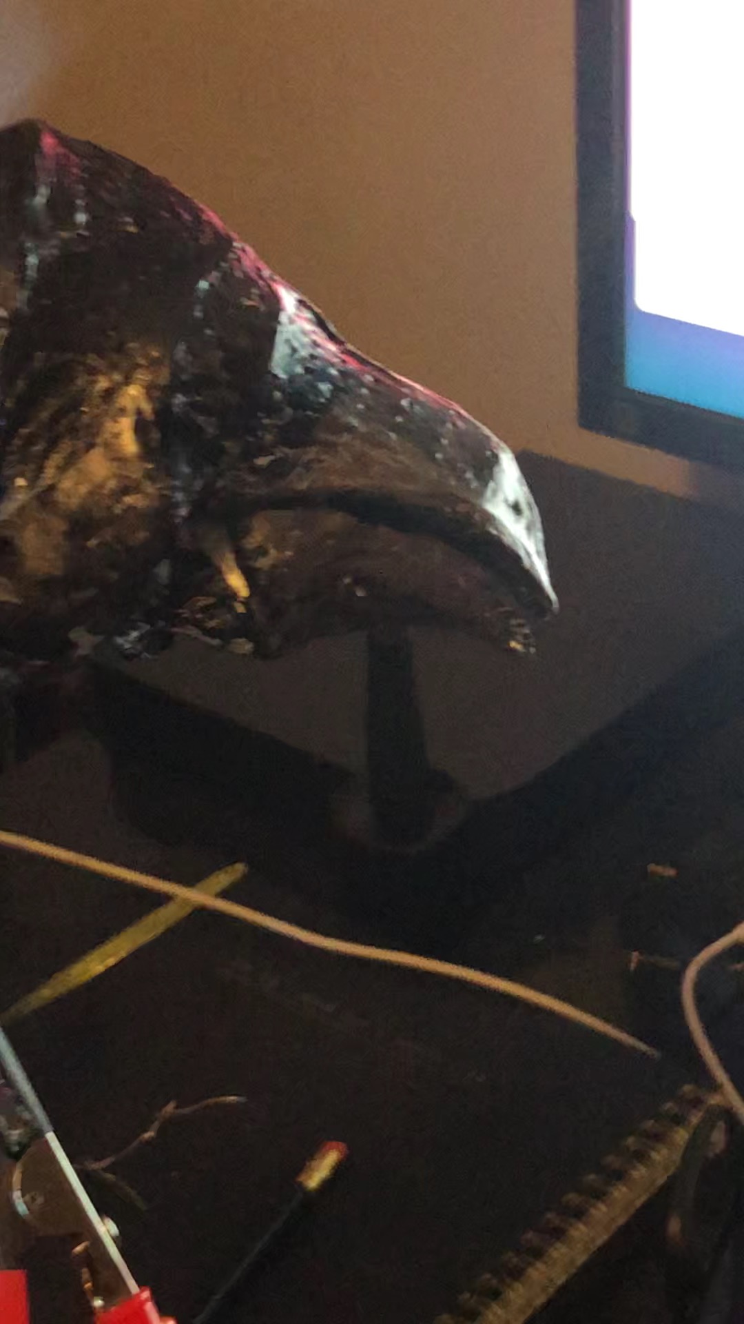

The funny thing is that, finding info about these motors is very hard so I have to test this my self on the breadboard. What I like to ask in here is what driver module/board to use ? I am planning to use a Nano for this project and this motor will open and close the beak of a little song bird when a mp3 player, randomly plays a sound. All is working perfect, just need to get motor and driver in place.
I now use a Tower Pro servo motor BUT the noise is of course unbearable

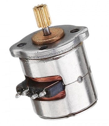

Here is pictures of the motors I will test out.
For bigger motors this would indicate current driven motors. The small motors may be voltage driven as well. Please clarify.
Depending on the operating voltage and current suitable for your motors.

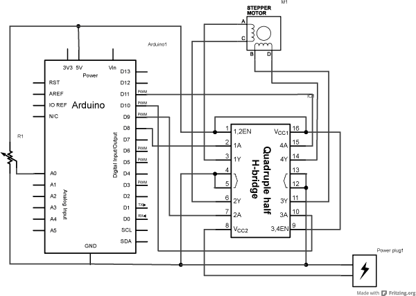

This might be a rare instance when a L293D or 754410 motor driver could be used as a stepper driver.
Use an external supply for the motor. The Arduino is not a power supply. An old 5V output cell phone charger would be a choice.
You could use the MobaTools stepper library to write non-blocking code (The Stepper library is blocking). The MobaTools documentation.

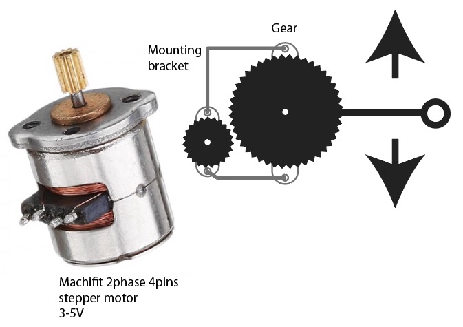

The documentation to be found about these motors are sparse (only what they write on AliExpress site) When I test it directly to the digital pins on a Nano board) I am well aware of the spikes the motor can throw back and damage the board but so far testing it is working nice. I have used the Arduino "Stepper.h" lib. It would be nice to get some gear equipment (with some sort of bracket system I can connect the motor to) Like this (is my idea so the torque gets a bit stronger)
...you risk to kill your Nano! The Arduino output pins are not designed for driving motors directly.

Are there any brand name / part numbers on the mtrs?
Can you post link to the Ali page where you bought them?
These are inefficient drivers from stone age, not applicable to current driven steppers. Look for modern MOSFET stepper driver boards that fit your (data sheet!?) motors

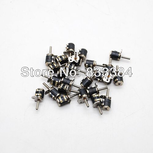

There are two motors I test now:
and
I know, but these was so tiny and perfect suited for my needs and they work perfectly

I found out a littlebit more about the Machifit micro motor: 80ohm (I don´t know the meaning of that) and that the steps are 18 degrees. I also found a site that has some doc about the motor but it is a version with gear on -the motor is still exactly the same Machifit: 5V DC Micro Metal Geared Stepper Motor - RobotDigg
