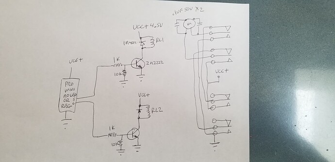

I have a project that basically takes input from some pushbuttons and if the combination is correct it drives a DC motor in one direction for one second, then waits, then drives it in the other direction for one second. This project works fine without the motor attached, but once the motors are attached the pro mini does erratic things. I have disabled the regulator and LED on the pro mini as this is a battery-operated application and therefore needs ultralow power. The wires on the motor feed are twisted and only about 4 inches long.
Any suggestions?

what kind of battery?
I cannot say for sure that the the problem is EMI but conversely I cannot say it is not without more information. Most MOS logic is fast and definitely edge sensitive. Keeping your leads (they are antennas) connected to the processor less then 10"/25cm which you did is good. What is needed is a description and or links to technical information. The power source could be collapsing or it could be coupling noise to the processor. The battery is important.
Diodes across the relay coils, but not across the motor.
Use two diodes from each motor terminal to VCC and two diodes from each terminal to ground.
Or a bridge rectifier, two AC terminals to motor, + to VCC, - to ground.
Not sure why you have used four relay contact pairs, while two would do.
Leo..
Circuit is driven by three AA batteries so 4.5 V.
I tried the bridge fix and that did not fix the problem, about the same.
I tried putting the motor power on one power source and the mini and relays on another and that did fix the problem.
I tried running the motor continuously on one power source and putting it right next to the mini, then put the mini and relays on another power source and circuit worked fine.
So I'm guessing that the noise is coming down the wire, not over the air.
I am using 4 contact relay pairs because there is another device driving the motor when this circuit is not in play and it needs to be isolated from this circuit.
Any other ideas for filtering options?
The diodes across the motor are also there to prevent relay contact burn, so use them.
Motor and MCU on the same (weak battery) supply is usually a bad idea. Voltage could dip briefly when motor uses more current during start-up (stall current), which could upset the MCU.
You can try powering the ProMini through a filter, consisting a Schottky diode in series and a ≥1000uF cap on the MCU side.
Leo..
I would use optocouplers to drive the transistor bases, thus isolating the processor from any ground loops that could exist and also shorten the wiring from the battery to the processor, also filter the processor power.
Sounds like all good ideas, how about replacing the relay drive transistor with a small 2A version SSR like this?
space is very limited on this project
Are you using the 5V 16MHz pro mini?
If so you need at least 3.8V for reliable operation, 4V would be a good margin
So 3AA batteries can be anywhere between 4.5V and 3V while they are discharging and may drop below the 328P BOD voltage when a motor turns on
I have both versions and can use either, but was planning on using the 3.3v version.
I am concerned that with low battery voltage I want the circuit to still function.
and as such I am using 3.3v mechanical relays.
without the voltage regulator in circuit what is the difference besides clock speed in the 2 versions?
sorry jim-p I was typing while you were.
The motor I am using only draws 22ma @4.5v unloaded and it will have a very small load on it when functioning. I understand start up currents can be much higher.
I suppose once I have this working I should test with some dead batts!
As far as I know nothing. The only ICs on the board are the regulator and the 328P
@mcuboy
The relays probably draw more that the motor, looks like maybe 120mA at 3.3V, more at 4.5V
That's your problem!
correct 110ma measured at 4.5v, So back to my question of, replacing the drive transistor with just the SSR?
so output of Pro Mini drives SSR which drives relay.
this gives me the isolation and smaller component count.
