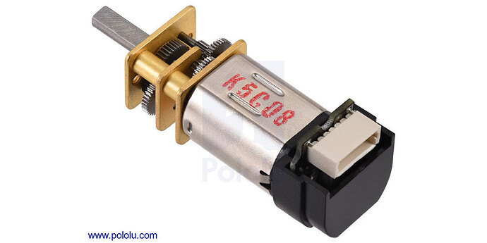

Maybe a lower gear ratio? I haven't tried them but here's a 5:1 DC motor with an encoder:
Look at the associated speed controller and see if it will do what you want. I am not familiar with such devices.
