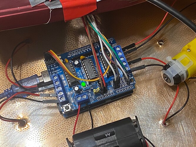

Motors Not Responding Properly with AFMotor Library (Arduino Uno + Motor Shield)
Hello, this is one of my first projects with Arduino.
The issue:
  • Initially, only M3 and M4 were spinning.
  • After a few tweaks (such as running a blink test), M1 started spinning, but M4 stopped working.
  • Now, none of the motors are spinning, even when using test code or direct commands through the AFMotor library.
What I’ve Tried
  1. Hardware Tests:
  • Verified motors work independently by powering them directly from a battery.
  • Checked all motor connections to the shield and ensured the wires are secure.
  • Ensured the motor shield is seated properly on the Arduino and powered adequately.
  1. Power Supply:
  • Using a separate external power supply for the motors (6x AA battery pack).
  • Confirmed the voltage is within the expected range.
  1. Library and Code:
  • Tested with a simple sketch using the AFMotor library (e.g., one motor running forward).
  • Tried basic examples from the library with no success.
  1. Reset and Re-Test:
  • Reset both the Arduino and motor shield.
  • Ran a “blink test” (toggling pin states on the motor shield), which worked at one point but now seems to have no effect.
  1. Motor Shield:
  • Inspected for loose solder joints or damage—everything looks fine visually.
Here is my code:

Also, the serial monitor shows that it is getting the commands.
I am also very sure that there is no hardware issue because I have ran multiple tests. I believe there is a problem with the code.
Long story short:
The AFMotor library uses both timers 1 & 2.
IRremote needs to use either timer 1, or timer 2.
They cannot share.
The solution is to use a motor shield that isn't a cheap clone of something Adafruit discontinued over a decade ago. Use the current shield, that's supported, doesn't use any timers, and doesn't use any pins other than the I2C bus.
Thanks for the insight! Actually, I'm not using the Adafruit motor shield. I'm using an L293D motor driver shield. Do you think that could be part of the issue, or is there something in the configuration I should check with this setup? I’m using the AFMotor library for motor control, and the IRremote library for IR communication. Any additional guidance would be really helpful!
The motor shield you are using is a cheap clone of the v1 Adafruit Motor Shield, which was discontinued over a decade ago by Adafruit. Cheap clones continue to abound because well, they're cheap, and people keep buying them. It uses timers 1 and 2. IRremote needs one of them for itself. That is the issue. Use the v2 shield. Or don't. It's your choice.
