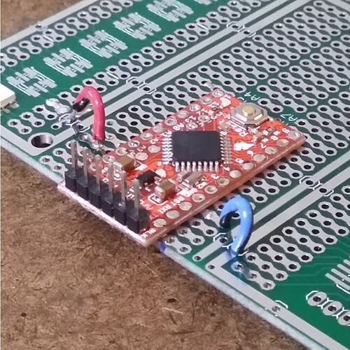

I made custom PCBs for use with Arduino Pro Mini's, where you can either connect it with pin header, or solder the Pro Mini directly onto the PCB.
They're available from my Tindie shop here: https://www.tindie.com/products/DrAzzy/project-board-for-arduino-pro-mini-/

A piece of regular perfboard would work just as well, but you'd haveto do a little more soldering to connect things. Perfboard also has mounting holes in the corners.
