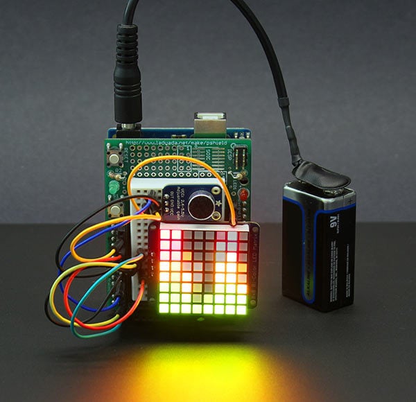

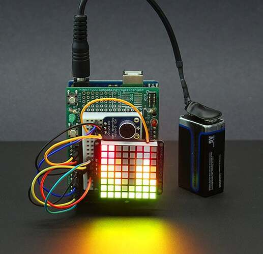

In another project by Adafruit :
They mention "Using the normal Arduino analogRead() function would be much too slow for sampling audio. Instead, a feature of the microcontroller’s analog-to-digital converter called free-run mode is utilized..... "
..... The raw audio samples are converted into a frequency spectrum using a fast Fourier transform or FFT...."
This is even more complicated for me.
