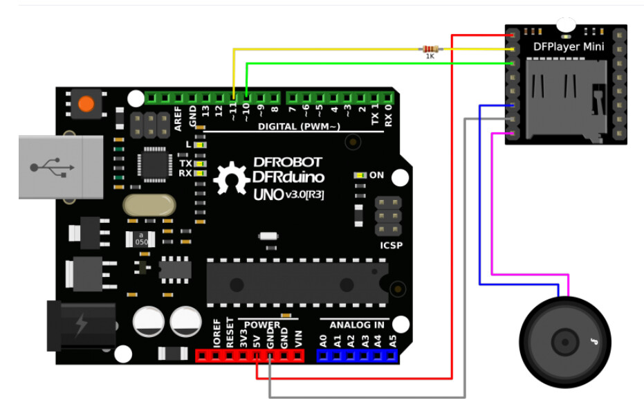

Instead of using SPK_1/2, I'm using DAC_R/L. These pins are both connected to a jack female (for external speaker) and PIN 5 of MSGQE7,
Both DFMini and LED (Adafruit/FastLed) work with their own libraries.

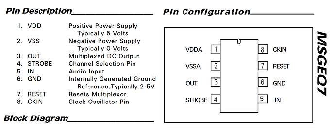

MSGQE7: [datasheet](https://mix-sig.com/images/datasheets/MSGEQ7.pdf)

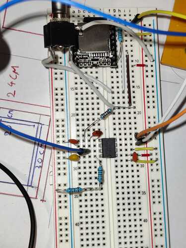

I'm actually following this schema, but I've connected only DAC_R, so remove L and 1 22 kohm resistor
To test this CHIP I'm actually doing this step:
Grounding ADKEY_1 of DFPlayer to start the music

Talking about MSGQE7, It's possible that i've made some connection error? I don't know how to make diagrams, so this is the real circuit (It's following MSGQE7 diagram, the white cable with my finger is DAC_R connecting to pin 5):
