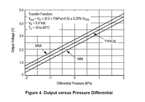

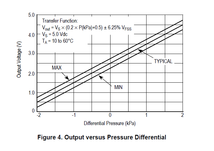

No, you power the sensor with 5.0 volts. With 5.0 volts applied and both ports at atmosphere the Vout will be 2.5 volts just meaning that it has an offset and that is intentional. Take a look at this figure from the data sheet.
The transfer function is pretty clear:
Transfer Function:
Vout = VS × (0.2 × P(kPa)+0.5) ± 6.25% VFSS
VS = 5.0 Vdc
TA = 10 to 60°C

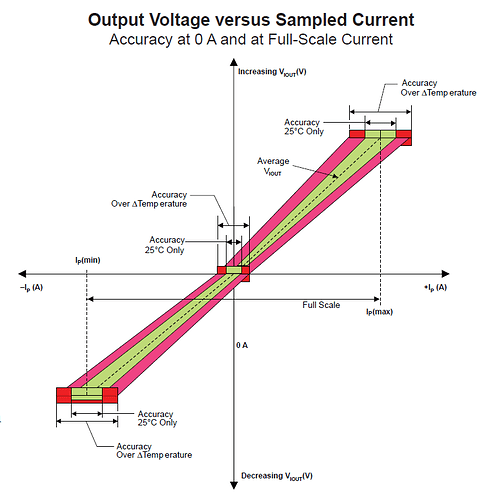

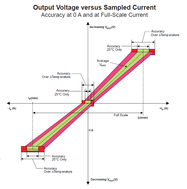

The data sheet is pretty specific about the sensor limits as in -2 kPa to 2 kPa and like you I have no idea how any of that could be derived, not to 7 kPa on either port. The total span is 4 kPa and that ranges from 0.5 volt to 4.5 volts for a sensitivity of 1 volt / kPa with a Vcc = 5 volts. The merit of the offset is simple. It's also pretty common in the sensor world. Here is a similar chart but looking at current rather than pressure.
The idea behind this it makes it easy to scale your A/D code for whatever units or engineering units of measure. Since using a 10 bit A/D like the Arduino and with a 5 volt A/D reference 0 to 5 volts = 0 to 1023 bits or 1024 quantization levels. So with 2.5 volts in you get about 512 bits which is zero units on either of the above charts. Makes for easy measure of negative units having the positive offset. Can't put a negative voltage with respect to ground into an Arduino.
