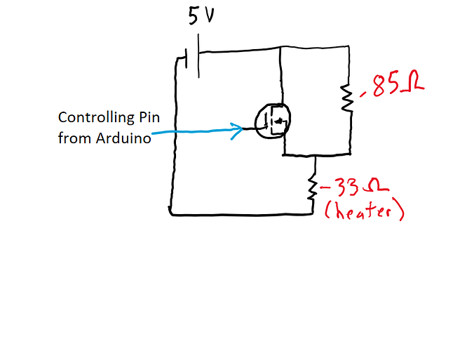

Hi Leo,
Thanks for your reply. If I understand what you're saying, then I agree it would be much easier for me to use a logic level MOSFET.
I believe you are suggesting that I put a MOSFET in parallel with a 82-85 Ohm resistor, with both connected in series to the 33 Ohm heater. When the MOSFET is off, all of the current will pass through the 82-85 Ohm resistor, resulting in ~ 1.4 V at the heater. When the MOSFET is turned on, all of the current should pass through the MOSFET, resulting in ~ 5 V at the heater. Is the attached circuit drawing roughly what you are suggesting? Based on my (limited) knowledge, I also think this should work, and appears much simpler to me. I have several Si2302DS MOSFETs I can use for this if you think it is appropriate.
Thanks!
Dustin
Can't switch high-side with an N-channel fet.
Source to ground, heater between 5volt and drain, resistor between source and drain.
Leo..
Got it!
Thanks for your suggestion. I'll give it a try.
BTW, do you (or anyone else) know why it was recommended to desolder some of the component on the breakout board for the MQ-7?
Can't tell for sure without a circuit diagram, but most of the components on that board seem to be used for the threshold detector of the digital output. Not used for the analogue output of the module.
Modification instructions seem to be missing on that destructables website.
Seems logical to measure the difference between module ground and module analogue out, with two Arduino analogue inputs, when the module is in 1.4volt mode (floating ground must also be measured).
If the resolution is too low, then use a P-channel mosfet (your diagram, but with source to 5volt), and measure output of the module with 1.1volt Aref enabled in setup().
Leo..

  4. In case it is of help to anyone, I am posting the circuit that was suggested by Leo. I have built this circuit, and it worked exactly as expected (thanks Leo). While I did physically build the circuit, for this group, I am also posting the results of the circuit simulation in case anyone finds it useful.
