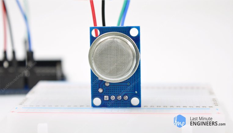

Does your sensor module look like this one?

Yes my sensor looks like this one only.

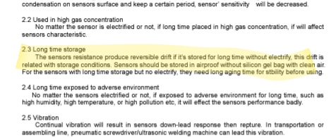

Look I have found this. Is this true
Cause I haven't used the sensor for more than 2 months

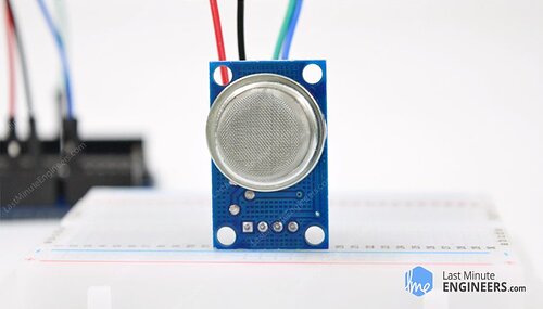

OPs sensor;

Vaibhav2710:
Leave the sensor powered for 24 hours and try again. Like I said: "You are supposed to keep the device powered up for 24 hours before trying to get a reading but I don't think that would cause a full-scale reading."
