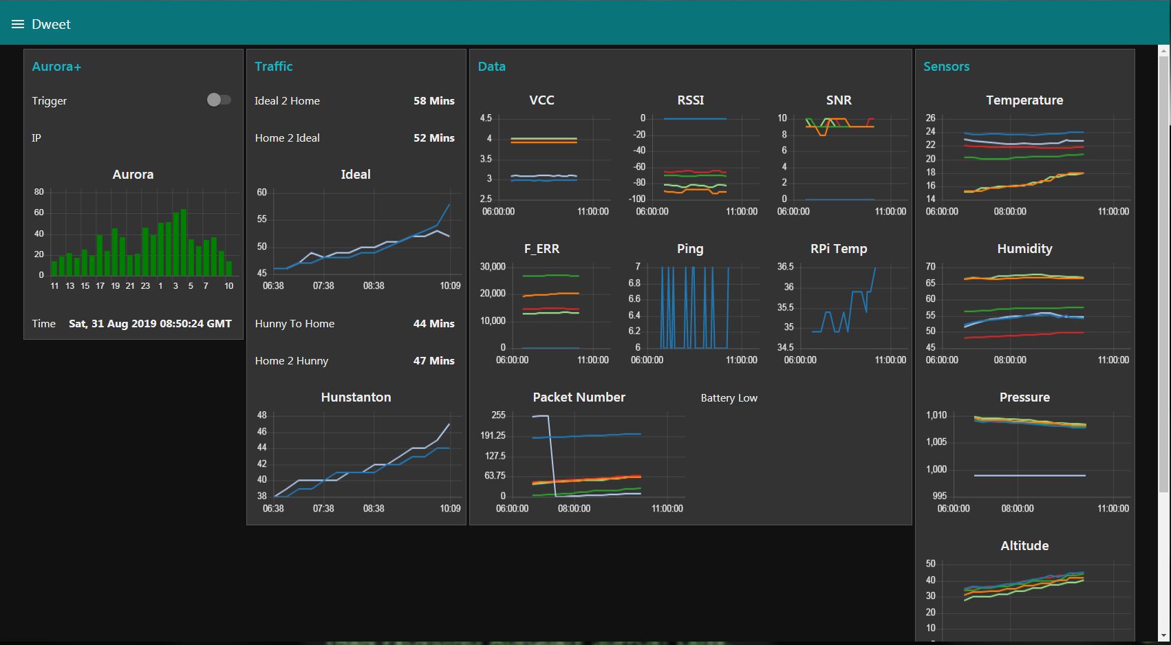

I use MQTT at home to send sensor readings to my home RPi server and then it logs/displays the data using Node-Red but also pushes the data to dweet.io. From work I use Node-Red to read the dweets and display the results on a dashboard, essentially mirroring what I get on my home network but without opening or forwarding router ports.
As the data frequency/usage is light (about once per minute at most) and is not critical (just weather sensors) a free dweet.io account is fine for my needs.

I have not included my flow as it has other stuff that is sensitive to me like API keys and my dweet.io things GUID's but I have knocked up a simple example for you to get the idea.
You will need to add node-red-node-dweetio from the pallet menu and to simplify things I have not used the dashboard but routed to debug nodes instead but included a screen grab of the Dashboard output
To give a bit of background, my sensors either send data direct to MQTT over WiFi (indoors) or via LoRa (outdoors) to a gateway on my network that forwards to MQTT.
The sensors send the data in a JSON string (example below) that consists of...
D = Device (L3 in the example)
N = Packet number
T = Temperature
P = Pressure
A = Altitude
H = Humidity
L = LUX light level (not all sensors have this)
V = Battery voltage
RSSI, SNR & F_ERR are only relevant to LoRa packets
TIME = Time of sensor reading.
{"D":"L3","N":24,"T":20.67,"P":1008.08,"A":43.17,"H":57.52,"L":0,"V":3.91,"RSSI":-70,"SNR":9,"F_ERR":26801,"TIME":"Sat, 31 Aug 2019 08:34:53 GMT"}
To make charting the data more readable I pad out any missing values with a preset so for example the above L3 sensor does not have a LUX light level reader so I pad with 0.
Hope this helps
