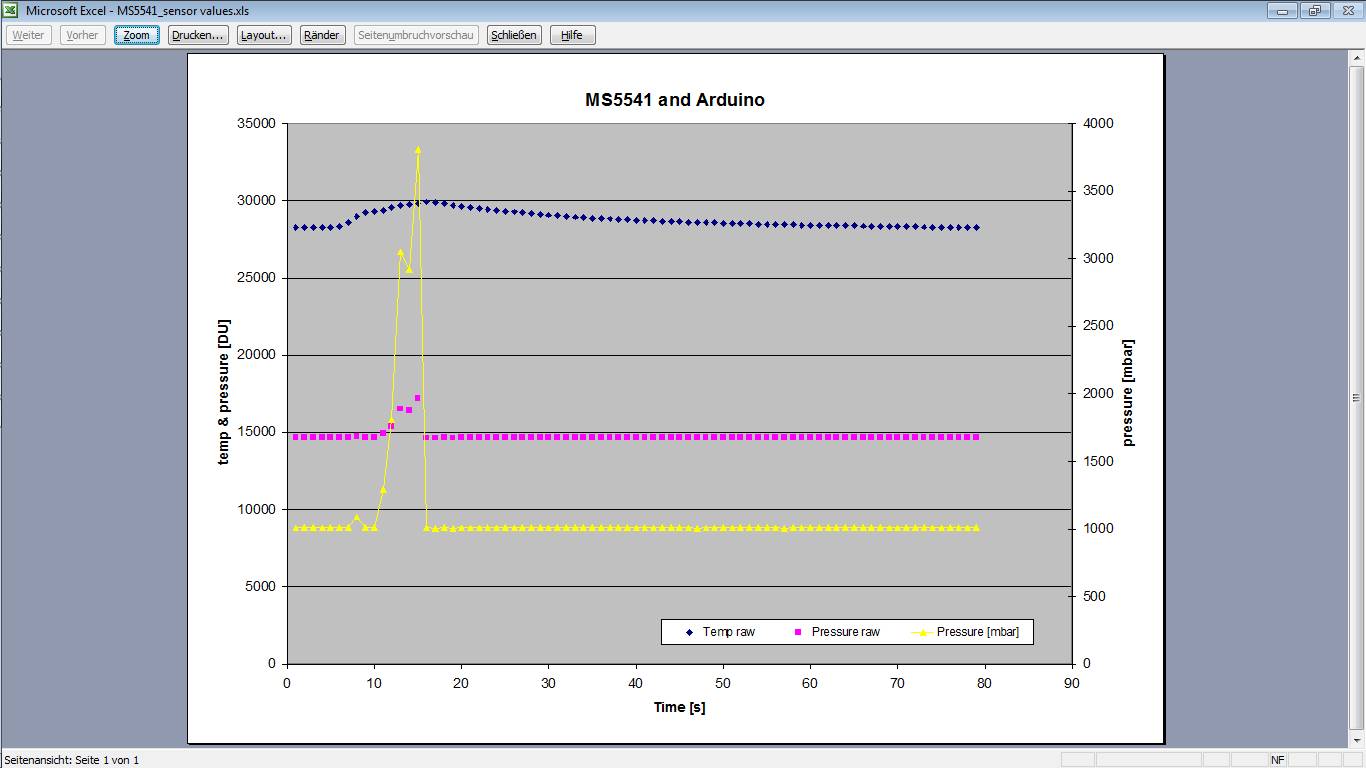

First it looked quite good, then I extracted the calibration factors (5422, 2908, 702, 366, 1202, and 27) from the calibration words (43378, 55058, 44978, and 46875) and I am pretty far away from the usual values in the datasheet. But who cares taking in account that the pressure and temperature reading is overflowing (both 65535)?
I am pretty sure my wiring is ok; the OSC signal is quite low (~0,2V), is that ok? I get it from pin 2 of a DS1307. Shall I better generate a signal with an I/O-pin? The 47µF Tn cap is not very close to the pins (~5 cm).
Thanks in advance, nice weekend to all!
PS: SPI.setDataMode is not really doing anything. Doesn’t matter if it is there or not or the other way 'round.
PPS: Tried another sensor. Different values, but in the same range. Obviously my code does not work.
The workflow for the temp and pressure values is wrong, but I don’t know how to do this:
Two additional clocks at SCLK are required after the acknowledge signal. Then SCLK is to be held low by the microcontroller until a high to low transition on DOUT indicates the end of the conversion.

I threw out all the ballast like chip select and Set.Data.Set since it did not make a real difference. Of course, with a couple of loops it will be leaner in the last version.
In the //temperature paragraph I tried a while-loop to wait until the sensor indicates end of data conversion by pulling the Dout line down, but I still get all 1s. In the meantime I can not completely rule out any more that the sensor is working properly, although I connected a spare one and the values differ in strangeness a little, but are neither really better nor worse.
As a programing noob I really would appreciate every advice I can get. One doubt I have about the reset command is if it is really send as a 24bit block or if there are gaps between each byte. I suppose it is put together during compilation so three seperate command lines in the sketch are as good as on sequence of hex numbers in brackets? Thanks very much in advance
Have a nice weekend
Sebastian
PS I measured with my DSO Nano from Seeedstudio but I did not see movement on sckl nor dout, but I am sure I’ve choosen the wrong settings. What is the speed of the spi communication? In what resolution can I expect to see something?
PPS I replaced the code on Monday, 8/15, with a new version since I found myself a couple of errors during the weekend. Calibration values are now well in the expected range. Speed is adapted. Still, the temp and pressure values are 11111111 11111111, so still no satisfaction. Come on, people! A tiny pressure sensor for about 30€ is a fantastic peripheral we really should make accessible for Arduino! :wink:
Hi there,
it works - somehow. Here the current version of the code:

Temperature is fine. Pressure is wrong and increases with every new measurement. Any thoughts?
Thank you.
You really should consider creating functions to reduce memory e.g. reset()
Can you post a sequence of values you got? Is the difference between two consecutive readings (nearly) constant ?
Formulas in the code are "quite complex" but I see no reason in the code. Can it be that the sensor does not reset properly?
Hi Rob,
once the code runs well I will make it slim.
In the annex is a graph of a 107 s measurement. I think my problem is in the wiring and not so much in the software, what o you think? I touched the sensor to generate some pressure at the point where the values drop. Even so they are quickly stable again, the compensated values climbs up to fall again…
I checked the formulas twice today, they are ok.
How could I check if the sensor resets?
Thanks

OMG, it works! Thanks man, thanks a lot! It seems to have been the "long"-thing, because first I changed the "0x7FF" to "0x1FF" with no effect. But now: joya! Pressing the sensor increased the value nicely, releasing it made it go back to 1007 mbar immediately. OK; now I will try to create a library and some loops to make it a little more neat. Again, thanks a lot!
And show us a new graph !!
If you want feedback on the library don't hesitate to ask (don't have such sensor but written/optimized a few small libs)
here is the new graph. You see nicely when I touched and squeezed it and how the temperature rises and slowly falls again.

  //calculation of the real values by means of the calibration factors and the maths
  //in the datasheet
  const long UT1 = (c5 << 3) + 10000;
  const long dT = D2 - UT1;
  const long TEMP = 200 + ((dT * (c6 + 100)) >> 11);
  const long OFF  = c2 + (((c4 - 250) * dT) >> 12) + 10000;
  const long SENS = (c1/2) + (((c3 + 200) * dT) >> 13) + 3000;
  long PCOMP = (SENS * (D1 - OFF) >> 12) + 1000;
  float TEMPREAL = TEMP/10;
  //2nd order compensation only for T > 0°C
  const long dT2 = dT - ((dT >> 7 * dT >> 7) >> 3);
  const float TEMPCOMP = (200 + (dT2*(c6+100) >>11))/10;
  Serial.print("Real Temperature [°C]=");
  Serial.println(TEMPREAL);
  Serial.print("Compensated pressure [mbar] =");
  Serial.println(PCOMP);
  Serial.print("2nd order compensated temperature [°C] =");
  Serial.println(TEMPCOMP);
  delay(5000);
