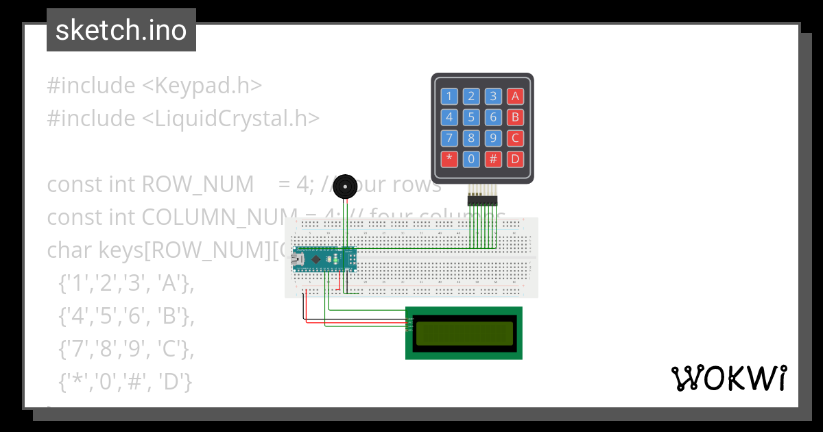

Visualization/communication aid.  Especially communicating with your six-months-from-now self.
@docdoc
I think a good strategy is to modify the void loop () code so it can perform the same function while performing the same task without using the while loop, I've tried removing the first while loop but the code did not proceed.
So how to retain the code function but removing the while loop.
  1. When asking for help it lets other people see exactly what you have. For example is there a disconnect between your code and the hardware. That includes, how much decoupling you have, do you need voltage level shifters between various components of your system. Have you added pull up resistors to any I2C busses you might have? And lots lots more.
  2. So that you know what you have when you get to do another similar project next year, you have some where to start from.
  3. If you ever want to publish the project or make that definitive You Tube video.
  4. When a friend asks you to make them another one.
  5. But most of all so that you can see what you have got.
Thanks for the part of the schematic you have shown. However:-
I thought that was your major problem, so is it completely missing?
:roll_eyes:
Yes that is the problem with using software to create your schematic. Unless you have the skill to generate the components you need then it is some what useless posting what you have done.
Three ways to go:-
  1. Learn how to create symbols in Tinker Cad.
  2. Find another drawing package that has those symbols, but it is a bit of a waste of time.
  3. Use a universal symbol drawing tool for drawing your schematic, like this one:-
Schematic Generator
It's the best way to handle this kind of things, but requires you to study and implement a finite state machine, and I think it'd be a bit tough for you based on your current knowledges. And I suggest you to always keep the loop() function more compact as possible, by packing each "logical section" into separate functions, it helps you to achieve a better structured programming and make debugging easier.
You always better post the full code, not just snippets, because we can't either see how the things are handled or even test it separately.
On any "new" thing you must handle (e.g. a specific function, or a new device/sensor...), always start writing a small sketch to test with a single topic is always the best practice, and helps you to better understand some possible solutions. Please note this is the same thing I myself often do.
In this case, forget about ultrasonic sensor and LCD, and keep just the buzzer and the keypad: try writing a sketch to ask for user input like the phone number, followed by an "end" key (e.g. "#"), with a single beep each time the user enters a digit, and print to serial the current stored number, then when "#" is pressed, exit with the resulting entered number.
You could even do that using any online simulator like Wokwi and/or Tinkercad, just to avoid building and connecting "real" devices. I strongly recommend you to start using such simulators, for both code testing and getting schematics!
Ok, so once you have made such sketch, you could edit it to pack the logic as a function (e.g. a "bool EnterPhone()") that stores the entered number in a global buffer variable (e.g. "char PhoneNumber[20]") and returns "true" (or resetting the buffer to a null string and returning "false" if the user pressed an "exit" key like "*" or for input timeout). This means you can then on your "main" program call the function and just check the returned value.
Ok, in case you need help, post here the full code and we'll have a look at it. But do things one at a time and/or one step at a time. Solve the phone number input and tone first, then create another test sketch for the ultrasonic sensor, and lastly put everything together in your "main" code. And if something don't work properly, almost always is something related just to the way you combined those procedures, and not the single procedure.
@docdoc
You are correct, so let's solve the key press beep input at first.
here is the full sketch that didn't work

@docdoc
HERE I made a simulation on Wokwi where I made a sketch just to print to the serial printer and in the same time make a buzz on every key press and it worked fine .
here is the full code

and here is the link
how do you find it ?

I tried to modify the code but it didn't work either as you can see from the link here.
So could you please check the problem with the code.
Here the link to the wokwi simulation

First of all, to use Serial prints you need to call "Serial.begin(9600)" (or whatever speed you need) from the setup(), and here you haven't added it.
Second, the connections appear to be quite "strange", you overlapped many connections, and it looks like you "mixed" a couple of wires. Always make clean drawings, with clearly understandable ad identificable wirings, and possibly distinguishing the various types of wires with different colors (always red for +5V, black for GND, and for example yellow for digital outputs, green for inputs, blue for I2C, and so on), and set wire routes with specific curves to avoid overlapping. This will also help you post here your schematics instead of paper and pen.
You could obtain this (it's your project where I changed a bit of things...):
Don't you find it clearer and more understandable than yours?
This is my version (you can save it on your project library and start from here):
Next, about the digits input code I think you need to start from scratch instead of going around with the same approach you had before. Clean the code up and start with a simple digits inputs (to be shown over Serial, forget about the display for a moment), where you ask the user to enter a number followed by a terminating character like "#" or reset the entered digits with another key like "C". And remember you should add every digit to a string buffer, use a global variable to make things easier (and not a "String" local variable).
I mean, forget about timeouts or any other thing, and focus on the keyboard input only, then making a short beep on each keypress. Use the same Wokwi project I linked you (btw keep the LCD for next develop steps) and try to create code for this first task, and post it here again if you need help.
I'm made some changes here,
but I didn't get the correct sequence which is,
you ask "Enter your phone NO."
then printing the numbers to the serial monitor.
while beeping at the same time
like here
KEY TO LCD Alex Copy - Wokwi ESP32, STM32, Arduino Simulator
you get only beeping with either entering the phone Number or asking
Enter your phone NO." .
