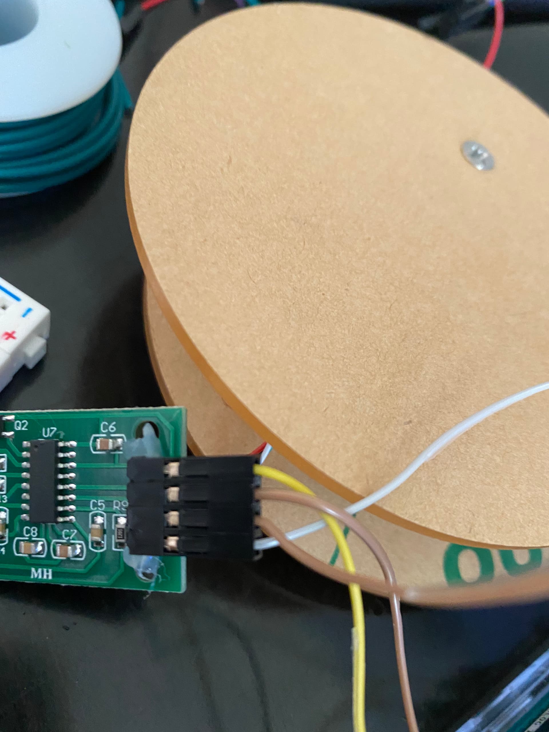

@chwaxy
1. Do you have a load Cell? If yes, then mount it on the bench as per Fig-1.
loadcellMount
Figure-1:
2. Do you have a HX711-type amplifier? If yes, then connect it with the load cell and UNO as follows:
(1) E+ point of the amplifier with E+ wire of the load cell.
(2) E- point of the amplifier with E- wire of the load cell.
(3) GND-pin of the amplifier with shield wire of the load cell.
(4) A+ pin of the amplifier with sig+ wire of the load cell.
(5) A- pin of the amplifier with sig- wire of the load cell.
(6) VDD-point of the amplifier with 5V-pin of UNO.
(7) GND-point of the amplifier with GND-pin of UNO.
(8) DT-point (Data Line) of the amplifier with A1-pin of UNO.
(9) CLK-point of the amplifier with A0-pin of UNO.
There is no need to connect LCD at the moment.
i did that, whats next
Take a picture of your setup and post it here to get the next help.
@GolamMostafa
Thank you!
Please, show me the Load Cell that you have mounted on the wooden bench using screws as per Fig-1 of post #17. This is a cantilever-type load cell that you have shown in post #1.
use different colors for the wiring.
This is the kind of hurrying that leads into accidential errors
that will cost you more extra time to analyse them than you need to search
carefully for different wirecolors
Vcc-wires: red or orange
GND-wires: black or blue
Data line / Clk different colors for easy distinguishing which is what
