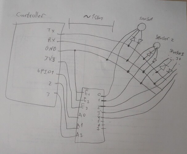

I need to read from several Atlas Scientific sensors (orp, do, ec and ph) over uart one by one. The sensors are physically close to each other.
I have the following limitations:
  1. have only 1 hardware serial port (software serial is not an option).
  2. the length between the sensors cluster and the controller is around 10 meters.
My idea for now is as in the attached image:
connecting all the sensors to the same Tx/Rx/GND wires (with diodes) and control their power with a decoder (such as 74HC238) using 3 GPIO pins, so I can enable the power for one at a time and read from it.
I prefer to use 9600 baud rate (as it's the default for these sensors).
My questions:
  1. Is the 10 meters limitation achievable without extra hardware?
  2. Is there a better solution?
Use RS-485 and enable the line driver of the selected sensor.

I would like to keep my system as low-cost as possible. If I understand correctly I need 1 + X RS-485 modules (1 for the controller and X for the X sensors).
I don't really mind about my controller, for now I have Adafruit feather M0 express.
I will sample once every 5 minutes.

The problem with what you propose is that even with the power removed they will probably draw power from the controller to their Rx pin through their protection diodes. Search for parasitic powering.
As already suggested, try RS485.

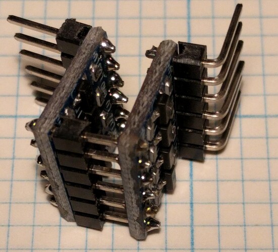

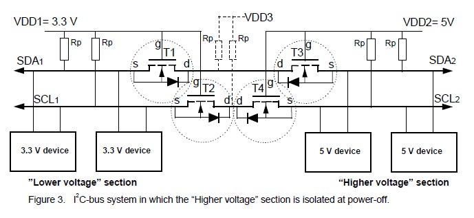

We used a level shifter that allowed the Tentacle board to be powered down between readings. They were built by hooking 2 generic level shifters back to back. In this configuration the "Lower voltage side" can also be 5V.
DualI2C
i2c_ls_bluec
The corresponding HV pins on the level shifters are tied together, the devices are connected to the LV pins on each side.
