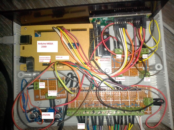

1--->I'm using External Adapter (9v 2A) to power on Arduino Mega via Vin.
2--->from the adapter I use LM2596 DC-DC Step Down Adjustable PSU Module fixed on 5v to power the voltage divider and the LCD (qapass lcd 16*2) with a 10k potentiometer for backlight adjust.

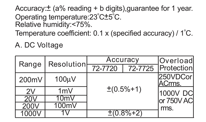

4-Multimeter (Farnell tenma 72-7725)
So everything works perfectly , I just have some issues that I would learn about :
1st--->When I power the arduino with Vin without USB cable , the readings on the LCD are changing fast , if the Temp is e.g 22° C on the lcd it's showing 15° C 20 , 25 , 12 , 19°C ..
Question1: I wonder why does this happen?
2nd--->When I plug the USB cable in the laptop to plot the Temperature ,first the sketch reset,second the readings are stable , so if the Temp is 22° C , on LCD it's 22° C ±0.1 !!
Q2: why the the arduino reset when I plug the usb cable ?
And why the readings are stable?
3rd--->When I take off the USB Cable , the LCD display wierd caracters "sometimes"until I reset the Arduino or power it off than power on again to get rid of these wierd caracters !!
4th--->if the Vin is off and the USB cable is plugged , I noticed that the the backlight of the LCD is on without any caracters despite of powering the LCD from the external +5v from the LM2596 , the only cables between LCD and Arduino are ofc RS , E , (D4-D7) and GND.
Q3: how or why this happens ?
5th--->I measured the 5v and 3.3v on arduino with the multimeter and I found respectivly 4.94/4.95 and 3.24.
Q5: is there anyway to increase it to real 5v or 3.3 ?!

Powering through Vin: sounds like a problem with your power supply. What are you using?
Powering through USB: sounds like the supply is more stable. I think it is normal for the Arduino to reset when you connect USB. In fact, even if the usb is already connected, opening the Serial Monitor will cause the Arduino to reset.
Wierd characters: could be another problem caused by your external power supply.
LCD backlight: you will need to provide a full schematic, and explain more clearly the configuration when this occurs. But it sounds like "parasitic powering" where power is flowing to the LCD backlight from an unexpected route. This is not a good thing and could be damaging the Arduino or other components.
Power supply voltages are often not exactly as advertised. Possibly your multimeter is not perfectly accurate either. Especially USB power via an Arduino, which contains circuits which are designed to protect the PC against wiring errors and have the side effect of dropping some voltage. Don't worry that it is not exactly 5V, this probably won't affect the accuracy of sensors because they give a signal which is proportional to the supply voltage.
5V for logic devices normally means anything in the range 4.75 to 5.25V - noone cares at all so long as it works.

Its absolutely crucial to power all your thermistor dividers from the Arduino 5V rail or none of your
measurements are ratiometric or meaningful.
Your LM2596 supply will be quite noisy as its switch-mode, further compounding your problem
with the readings.
