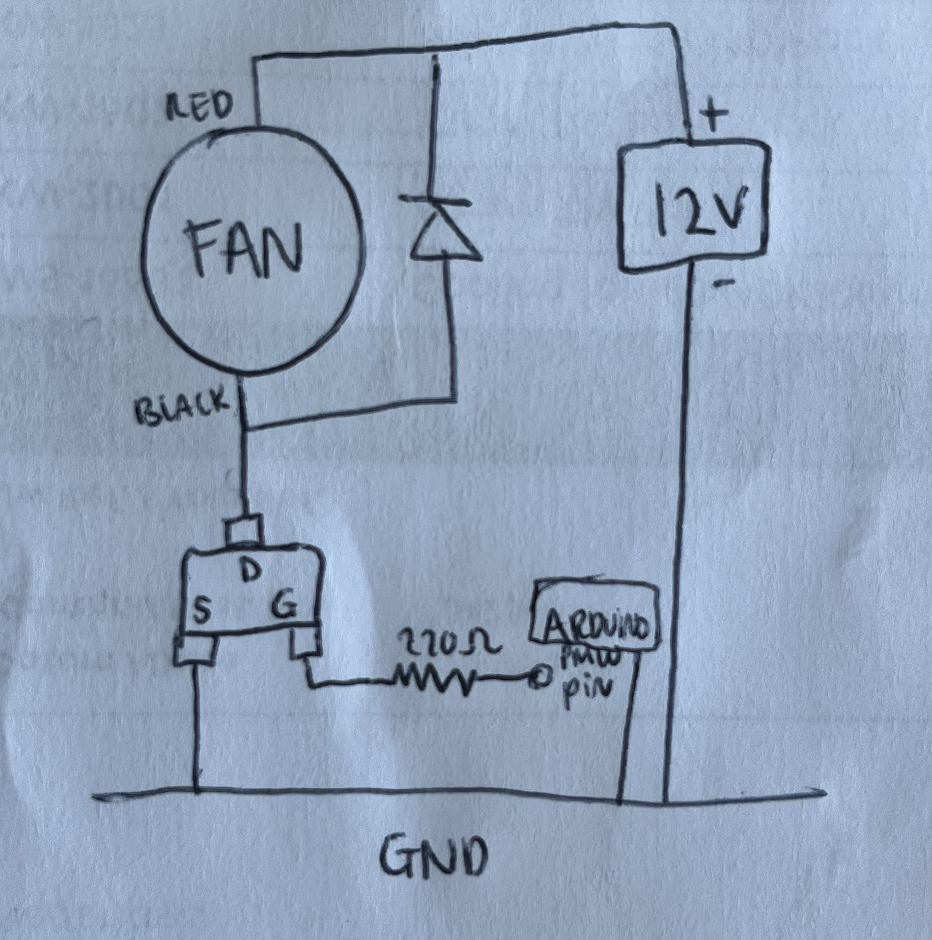

Hi, I want to control multiple (like 5?) fans with an arduino/microcontroller.
I started with wanting to control multiple 12V fans, and so I figured the way to go was like this, where I connect the black wire of each fan to the drain of the mosfet, the source to GND, the gate to a 220ohm resistor and then to a PWM pin of the arduino. I got a 12V 2A power supply for all this.
Now I found this 5V fan, which feels stronger in wind than my 12V test fan, so I'd like to use it instead. Anyways, I got stuck thinking about how to power these. The Arduino doesn't provide enough current (0.4A only?) to power it, but my power supply has too much voltage.

You cannot use the Arduino to power any fan.
You must have a separate power supply to suit the fans you use . The Arduino can switch them via a transistor .

Do I still need a mosfet for this?
No, you control the speed using the fan PWM signal input.
You shouldn't do that. When the MOSFET is off you have 12V on the fan positive wire and the Arduino PWM pin connected to the fan, with nothing on the fan negative connection. You have a path for current from 12V through the fan to the Arduino. If you have not damaged it consider yourself lucky.

Oh. How then to do it?
I was thinking this for the 12V fan:
And then this for the 5V one:
You can use 12V to 5V step down converter, but honestly, doesn't make sense to me.
5V2A power supply doesn't really cost more and most of people have those laying around (usb chargers).
You just connect the fan to the power supply and write pwm-pin low when you want to stop the fan.

So is my drawing okay for that? Yellow is the PWM wire, so I just connect that one to the arduino and leave the blue out.
Yes.
Thanks for the schematic, perfect example of why we ask people to post one at the start of a topic. From your initial description I thought your 12V fan had 3 wires: Positive, negative and PWM. Your schematic for the 12V fan is much clearer than your description. Your schematic for 12V is fine, you can do that.
For the 5V fan that also looks OK, although I'm not sure of the function of the yellow and blue wires.
Thanks! Yellow is pwm, blue is tach.
NO.
The BLUE wire is for PWM input to the fan
No need for the diode.

Now all you need is the code for generating the 25kHz PWM for the fan.

In the 12V scheme I do need a diode right?
Why is this not needed anymore in the 5V scheme?
Yes
The diode is there to protect the MOSFET from voltage spikes but with the 5V fan there is no MOSFET.
