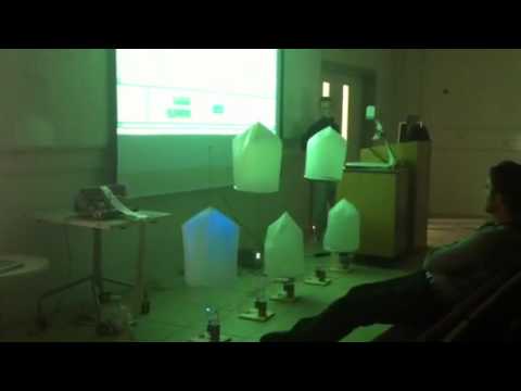

I have been trying to do something similar to yourself(i used rc plane props and drill motors), you can see my results in the vid above. I'd be happy to help if I can.
It's a great creative idea. I would like to see the result
