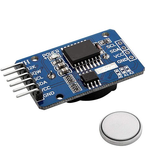

Múltiple devices on i2c, RTC won’t start or give the time
Hi all!
I have developed a project consisting in 16 mlx90514 ir sensors connected to an ElegooKit arduino mega vía SDA and SCL through several meters of wire. I have also connected an DS3231 rtc to the same pins. I have managed to make everything work properly when connected on their own and It even works when some of the MLX and the RTC at the same time but not all at the same time. Then the rtc does not begin() (RTClib.h) or it begins but the time is fixed. I also use the wire .h lib for the MLX
I have read a lot and I realize I may have several problems, too many devices on the same i2c bus and too much cable length leading to too much capacitance.
I don’t have an address conflict. IR Sensors are 0x1A to 0x4D and rtc is 0x68
…what is the simplest solution, pull up resistors? multiplexer? I think I have already tried the 2 ways to connect SDA/SCL.
Any help will be appreciated. I will share the code if needed but I don’t think is the problem.
Thank you!
Edit:
Everything is on 5 volts, including an SS card module
I have also read that changing the speed of the i2c can help, true?
If you don't have them you don't stand a chance of it working. Might not get it working anyway with just these but without any there is no chance.
How many of the modules on the I2C bus have pullup resistors installed on their boards? Too many pullups (too low of resistance) is bad, too.
I believe the 17 have pull up resistors . I just don’t know if I need to change anything in that aspect.

Why is that?
You link is to the data sheet of the chip, that clearly doesn't have a pull up resistors. Yes it shows them on a typical circuit, but it is my guess that you have not got just the chip but, the chip built into a breakout board with other components on it.
If that is correct there may or may not have the pull-ups on the board, or they may be connected on the board and are enabled or disabled with a solder link.
Can you post a link to where you bought the board from.

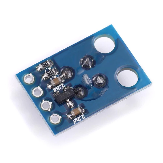

The rear of your sensor modules shows 2x 4K7 pull-up resistors. These are the small black rectangles with "472" written on them and will need to be removed from each module.
can you develop please? what are the consequences of removing them? I am afraid they will not work anymore
the IR sensors part works great, I was looking more for an answer to make the RTC work
I²c pull-up resistors should be in the range 2K to 10K. These are in that range, but 16 of them in parallel is equivalent to 1/(16*(1/4700)) = 293 ohms, which is way below 2K, and so the bus won't work. That's why you need to remove them.
It may not be the only reason the bus is not working. The long cable lengths can be a problem, as you know, and as @Grumpy_Mike points out, you need to change the addresses of 15 of your 16 sensors so that all 16 are unique.

Adafruit sells the Melexis sensor as a 5V version and a 3V version, so then you know what to buy for a project that is 5V (with a 5V Arduino board) or for a project that is 3.3V (with a 3.3V Arduino board).
Which version is on your module ? Can you power the module with 5V and then measure the 3 pins of the voltage regulator ?
If it is the 3.3V version, then you may not connect the 5V I2C bus from the Mega to it.
Adafruit sells the DS3231 as a normal working module for a normal battery.
Your module damages the (rechargeable) battery when powered with 5V.

Removing those 4k7 from all the modules is not hard when you know how :sunglasses: Some heat up both sides quickly and wipe it from the board. I take a big blob of solder and heat up the whole resistor and let it fall off. It should only take 1 to 3 seconds.
ok, I just learned how to do it and it was not too hard.
How does this thing work, shall I remove some of the resistors, or all of them?
can I remove just one resistor per sensor? is this a quantitative thing?
mind that today I have 16 MLX together but in the future I may have less and I want it to work.
Thank you
Yes, of course. You need to calculate the total resistance of all the pull-ups attached to the SDA & SCL lines and remove resistors until that total is between 2K and 10K. But these resistors are in parallel, so to calculate the total resistance Rt:
1/Rt = 1/R1 + 1/R2 + 1/R3 + ...
Max standard I2C pull up current is 3mA,
which works out to a pull up resistance of 5volt/3mA = 1.67k minimum for 5volt logic.
The Mega has fixed 10k pull up resistors, and the RTC seems to have 4k7.
With ohms law you can calculate how many resistors you need to remove from the MLX modules to get to or above that value.
If it doesn't work after that then review your wiring or lower the I2C clock speed.
