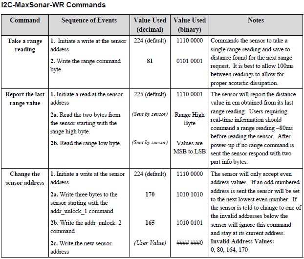

Didn't change it, but my question is why he wrote the register pointers parts ?
These are my sensor commands ( try to open them on a new window for clearer image )
So, do I need to do the register parts ?
I haven't got the chance to test it. Can I improve the code? and how to write for it to measure real-time as it suggest above ?

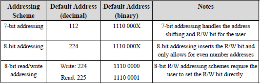

Is everything inline with the image of the commands ? I'm only doing the first two commands.
in the tables there is no mention about a register address. device address is 112 decimal and in the code it is used in beginTransmission and the command "take a "range reading" 81 decimal (51 hexa) is written.
Juraj:
So, the code is good ?

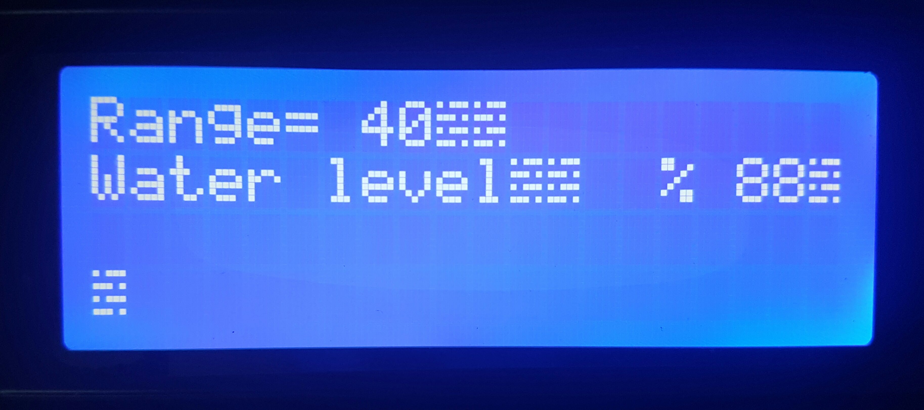

Thank you. I got it to work finally!
At first, it didn't work. But, I did run I2C search sketch to make sure ( this problem happened before and took me months to figure it out )
I found the address is 56 Decimal.. I don't know why the address has changes. Edited the code and worked.
Also, implemented your suggestion.
I have problem with LCD screen.
and code
//LCD
#define BACKLIGHT_PIN 3
LiquidCrystal_I2C lcd(0x27, 2, 1, 0, 4, 5, 6, 7, 3, POSITIVE);
  lcd.begin(20,4);
  Wire.begin();
  Wire.setClock(400000L);
int Range=0;
int Percentage;
  lcd.setBacklightPin(BACKLIGHT_PIN,POSITIVE);
  lcd.setBacklight(HIGH);
 // Step1: instruct sensor to read
  Wire.beginTransmission(56);
  Wire.write(byte(0x00));      // sets register pointer to the command register (0x00)
  Wire.write(byte(0x51));      //81 decimal
  Wire.endTransmission();      // stop transmitting
  // step2: for reading to happen
  delay(250);
 // step 3: instruct sensor to return a particular echo reading
  Wire.beginTransmission(56); // transmit to device #112
  Wire.write(byte(0x02));      // sets register pointer to echo #1 register (0x02)
// step 4: request reading from sensor
  Wire.requestFrom(56,2);
// step 5: receive reading from sensor
  if (2 <= Wire.available()) { // if two bytes were received
    byte hi = Wire.read();
    byte lo = Wire.read();
    int Range = hi * 256 + lo;
    Range = constrain(Range, 25, 150);
    Percentage = map(Range, 150, 25, 0, 100);
  Serial.print("Range= ");Serial.println(Range);   // print the reading
  Serial.print("% ");Serial.println(Percentage);
  lcd.setCursor(0, 0); // top left
  lcd.print("Range= "); lcd.println(Range);
  lcd.setCursor(0, 1); // bottom left
  lcd.println("Water level");
  lcd.setCursor(15, 1); // bottom right
  lcd.print("% "); lcd.println(Percentage);
  delay(300);
