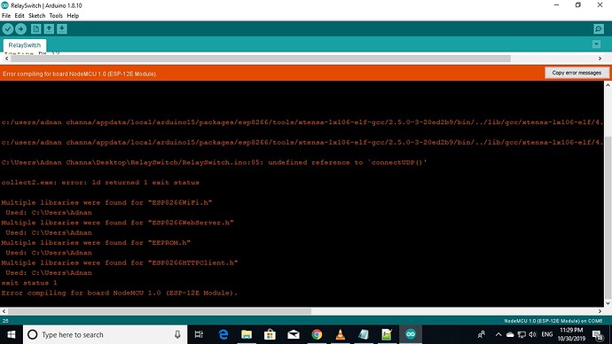

Multiple libraries were found for
Hello Guys I have got such problem in NODE MCU any idea?
c:/users/adnan channa/appdata/local/arduino15/packages/esp8266/tools/xtensa-lx106-elf-gcc/2.5.0-3-20ed2b9/bin/../lib/gcc/xtensa-lx106-elf/4.8.2/../../../../xtensa-lx106-elf/bin/ld.exe: sketch\RelaySwitch.ino.cpp.o:(.text.setup+0x34): undefined reference to `connectUDP()'
c:/users/adnan channa/appdata/local/arduino15/packages/esp8266/tools/xtensa-lx106-elf-gcc/2.5.0-3-20ed2b9/bin/../lib/gcc/xtensa-lx106-elf/4.8.2/../../../../xtensa-lx106-elf/bin/ld.exe: sketch\RelaySwitch.ino.cpp.o: in function `setup':
C:\Users\Adnan Channa\Desktop\RelaySwitch/RelaySwitch.ino:85: undefined reference to `connectUDP()'
collect2.exe: error: ld returned 1 exit status
Multiple libraries were found for "ESP8266WiFi.h"
Used: C:\Users\Adnan
Multiple libraries were found for "ESP8266WebServer.h"
Multiple libraries were found for "EEPROM.h"
Multiple libraries were found for "ESP8266HTTPClient.h"
exit status 1
Error compiling for board NodeMCU 1.0 (ESP-12E Module)./>
Very simple: the compiler is missing the function "connectUDP()". That looks like a missed library.
Without your sketch there is not more info.
Please read the post at the top of this forum! (MOD EDIT)
thanks dear and what about  Multiple libraries were found for "ESP8266WebServer.h" ?
If you use the IDE Arduino 1.8.10 simple ignore it.
Is is a small malfunction of the actual IDE - but not enough for a new Version.
